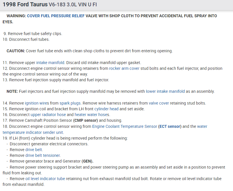

I bought this car a week ago and the previous owner flushed the radiator before I took possession but it overheated after driving for twenty minutes and now will not start it turns over but will not start? Is there a fuse or electronic control?

Was there any smoke out of the tail pipe?
Since it overheated and won't start I am suspecting a blown head gasket.
Typically you will get white smoke out of the tail pipe if the head gasket blows while you are driving.
https://www.2carpros.com/articles/white-smoke-or-steam-coming-from-the-exhaust-pipe
If the head gasket is blown, you will likely see milky color oil, due to coolant being mixed.
You can also do a test to see if the head gasket is blown, by using a tester. It detects combustion gases in the coolant.
Here is a video instruction:
https://youtu.be/5zpNjYmmiYY

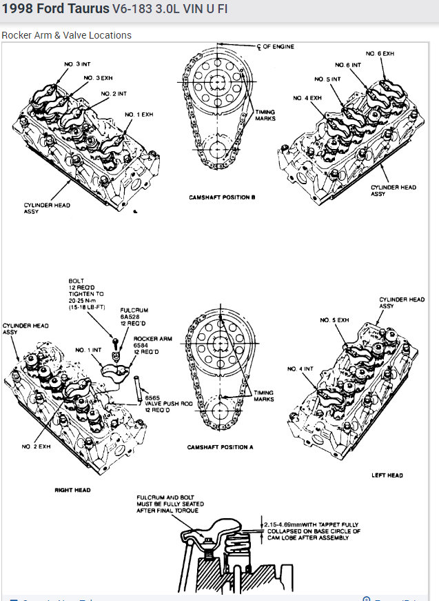

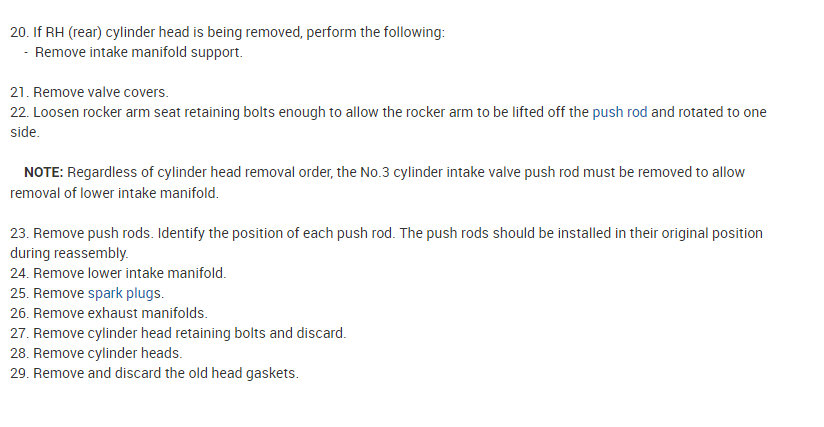

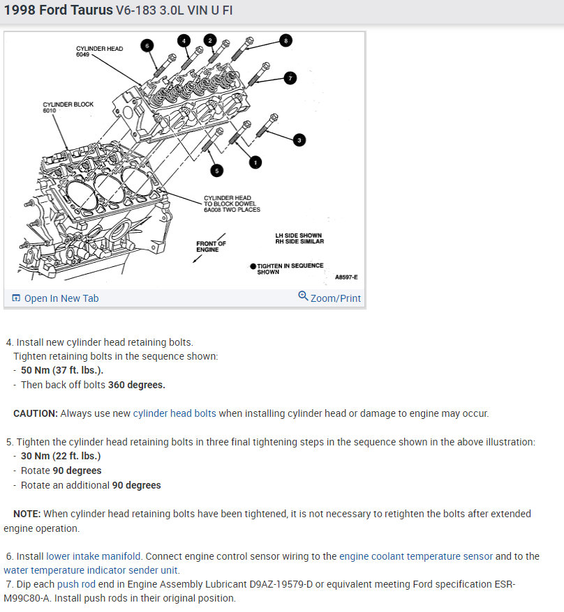

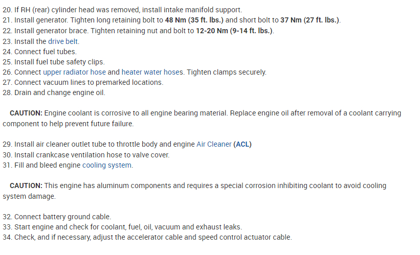

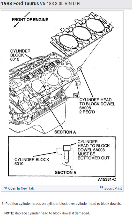

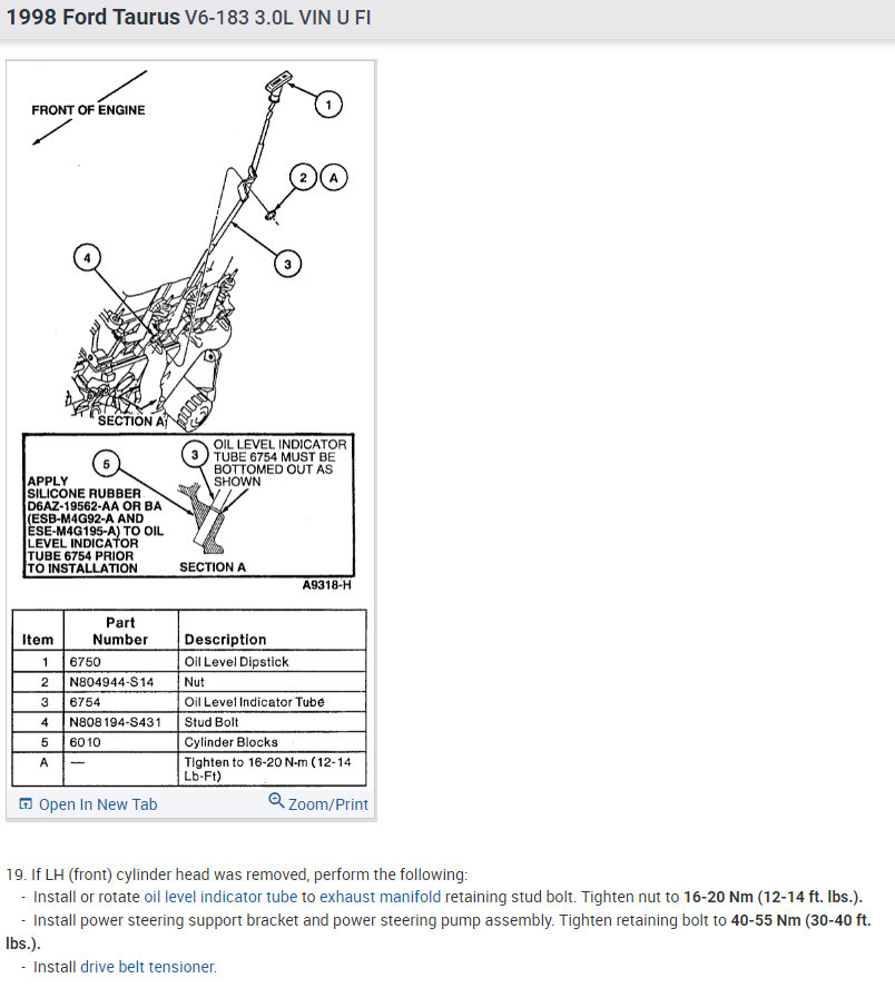

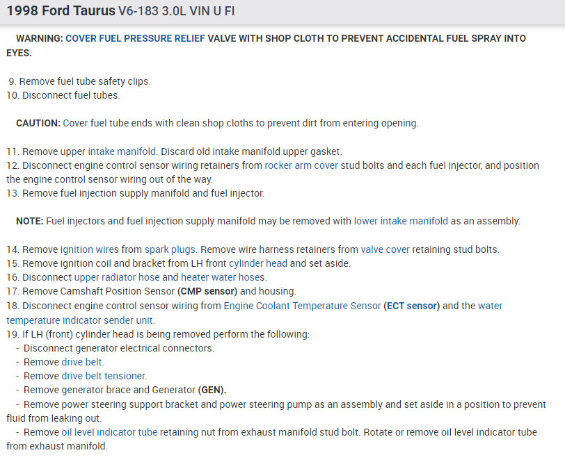

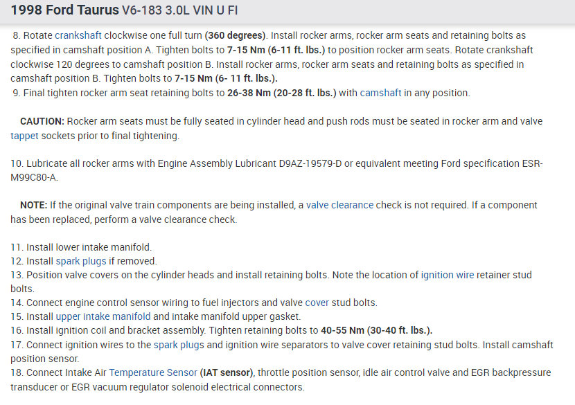

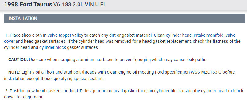

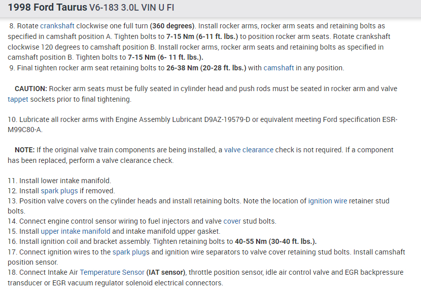

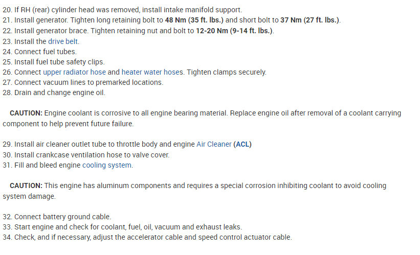

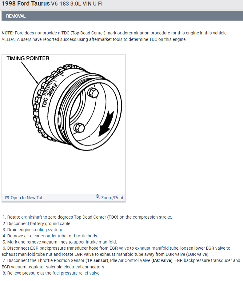

I have also attached the head gasket replacement procedure.
