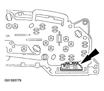

In getting the car inspected, I was told the check engine light was burned ut. How do I replace?
Saturday, October 24th, 2020 AT 12:20 PM (Merged)
BMRFIXIT
  • 19,053 POSTS
Lights is in the instrument panel
remove the instrument cluster
need manual CHECK IT @
https://www.2carpros.com/kpages/auto_repair_manuals.htm
https://www.2carpros.com/forum/automotive_pictures/99387_Graphic_38.jpg
