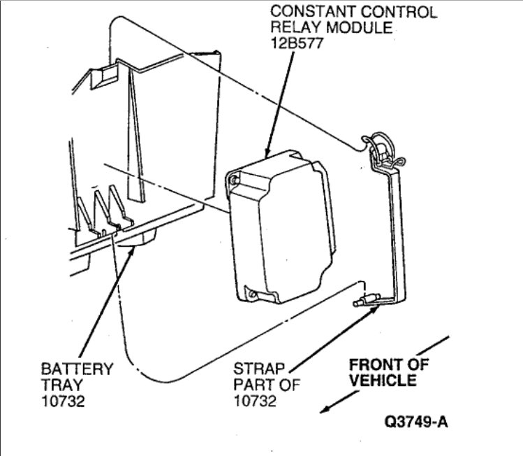

Can anyone help me find the fuel pump relay in my car? According to the Chilton's electrical diagram of the car there is one on it, but they fail to mention anything regarding its location. Is the fuel pump relay perhaps inside of the control module?
I have checked the inertia switch, verified gas is not going to the engine by removing the line before the gas filter, replaced the pump to my dismay, and made sure the fuse not broke. I have also checked the fuse box underneath the steering wheel, underneath the hold, and also checked underneath the driver's seat with no luck.

The fuel pump relay is incorporated in the constant control relay module located next to the battery. I would recommend spending the extra money and purchasing it from the dealer instead of the local auto parts store as I learned the hard way.
HEre are some guides to help you test it.
and
Here is its location (below)

Hi mr.smith_5, Welcome to 2carpros and TY for the donation
Dunno what liter engine but am using a 3.0 liter-the fuel pump relay is integrated with the constant control relay module-see below for location
https://www.2carpros.com/forum/automotive_pictures/12900_ccrm_1.gif
Disconnect battery ground cable, then remove radiator sight shield.
Disconnect electrical connector, then remove module from radiator support.
Reverse procedure to install.

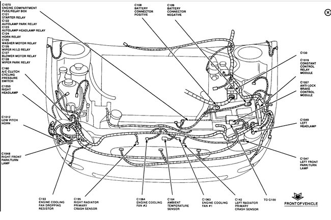

Where is the Fuel Pump Relay Located?
+1
Friday, November 3rd, 2017 AT 5:25 PM (Merged)
  • 75,992 POSTS
https://www.2carpros.com/forum/automotive_pictures/12900_fprf_2.jpg
The Fuel Pump Relay is part of the Integrated Control Relay Module, is located at the front of the engine compartment, on the upper radiator support.

It may be located in the ccrm black box, located on top of the radiator, under the sight shield. I don't believe it is serviceable. There are a couple other items in there also, a c relay, fan control relay. Unplug the fuel pump connector to the inertia switch, apply 12 volts to the plug, listen for the fuel pump to turn on to confirm pump is good
