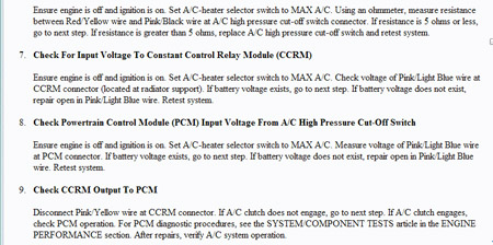

I am trying to debug an A/C issue and need some input. 97 Taurus with 114000 miles. A/C has alway been stable until recently when compressor froze up. I replaced Accumulator, Compressor, Orifice, oil and freon. After recharge I noticed that Radiator Cooling fans did not immediately engage when A/C switch was turned on. I checked my 98 Taurus and Fans came on instantly.
Goes like this.
Turn on A/C, no fans. A/C begins cooling and pressure rises on high side, low side goes down as expected. High side continues to climb until 350 psi when compressor shuts off and the cooling fans come on. At about 100 psi COmpressor turns back on and fans are still on keeping pressure at 150 psi. Then fans turn off and pressure rises back to 350 psi where cycle strats all over again.
What I know. I think A/C high pressure switch is fine (replaced anyway) and A/C clutch switch is good. I am not sure about the CCRM (Constant Control Relay Module).
Assumption. I do beleive cooling fans should engage immediately when compressor turns on. SOme I am thing CCRM or fuse or?
Anyone know of any test I can run to help find out why fans do not come on with A/C switch?

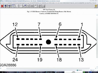

Probably going to be looking at the CCRM conncetor, for burnt or bent or pushed out pins, and burnt wires...
https://www.2carpros.com/forum/automotive_pictures/62217_CCRMa_1.jpg
You might want to click on the link in my sig file, there are 85 steps in diagnosing the fans, and CCRM and PCM...

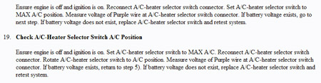

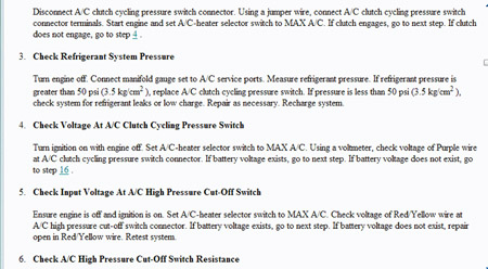

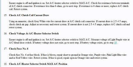

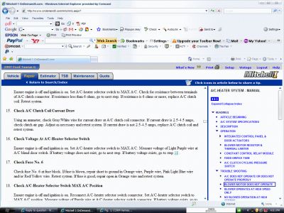

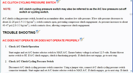

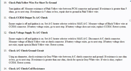

First thing is make sure the ECT which is the engine coolant temp sensor is in range, then check this info out
https://www.2carpros.com/forum/automotive_pictures/62217_ac1_1.jpg
https://www.2carpros.com/forum/automotive_pictures/62217_ac2_1.jpg
https://www.2carpros.com/forum/automotive_pictures/62217_ac3_1.jpg
https://www.2carpros.com/forum/automotive_pictures/62217_ac4_1.jpg
https://www.2carpros.com/forum/automotive_pictures/62217_ac5_1.jpg
https://www.2carpros.com/forum/automotive_pictures/62217_ac5_2.jpg
https://www.2carpros.com/forum/automotive_pictures/62217_ac6_1.jpg

CCRM (Constant Control Relay Module) was faulty and had to be replaced.

CCRM was replaced with one from Ebay and all is good now!
