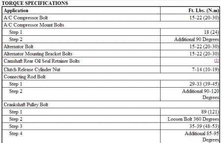

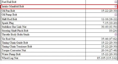

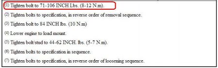

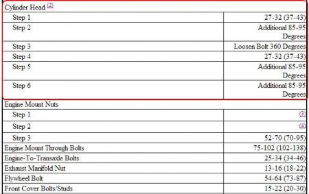

my eng ran hot and blowed head gaskets I need the specs to replace them and on the intake
