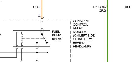

ok I had my starter checked 2 times and both times they said it was good. Them problem is when I put it back on and turn the key all I hear is click noise if I get trying it it will turn the motor over slow I have a new battery and even tried to use a booster and still the same. Two days ago it was fine. When I take the starter off it is very hot and the motor hasnt been running. Please please help its driving me crazy thanks larry

Check and test the starter relay thoroughly

Thanks for answer so fast where would it be on a 1996 in the front fuse panel? Thanks do you have a diagram you could show me? Again thanks larry

The fuel pump relay is in the constant control relay module
https://www.2carpros.com/forum/automotive_pictures/12900_ccrm_3.jpg
