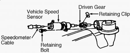

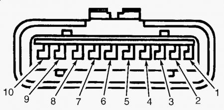

TESTING SYSTEM INOPERATIVE 1. Check Power To Servo - Unplug harness connector from servo. Turn ignition on. Using DVOM, measure voltage between pins No. 7 and 10 of servo connector. See Fig. 1 . If battery voltage exists, go to step 4). If battery voltage does not exist, go to next step. 2. Check Power To Servo - Turn ignition on. Check for battery voltage between servo connector pin No. 7 and chassis ground. If battery voltage exists, go to next step. If battery voltage does not exist, check fuses and replace as necessary. If fuses are okay, repair open power circuit. If fuse repeatedly blows check circuit for short to ground and repair as necessary. 3. Check Module Ground - Measure resistance between servo connector pin No. 10 and chassis ground. If resistance is less than 5 ohms, repeat step 1). If resistance is greater than 5 ohms, repair ground circuit. 4. Check Deactivator Switch Circuit - Turn ignition on. With brake released, measure voltage between pin No. 9 at servo connector and ground. If battery voltage exists, go to step 7). If battery voltage does not exist, go to next step. 5. Check Power To Deactivator Switch - Disconnect deactivator switch harness connector. See DEACTIVATOR SWITCH LOCATION table. Check for battery voltage at deactivator switch Light Green/Red wire. If battery voltage exists, go to next step. If battery voltage does not exist, check for blown fuse or open circuit. Repair as necessary.

I was following the testing instructions you sent me and got to #4 where it says to measure voltage between pin 9 of the servo connector and ground. There is not a wire in position 9 or position 3 on the servo connector. I looked to be sure the wires did not come out of the connector and it appears there never were wires in positions 9 and 3. The next test I did was #7 where I checked the stoplight switch. There was battery voltage between pin #4 on the servo connector and ground which according to your instructions, indicates a bad stoplight switch. However when I press the brake pedal, the stop lights come on and when the pedal is released, the stop lights go off. Could the switch still be bad and need replaced?
All other tests through step #7 I could do, not involving pin #9 checked out OK.

Hello. Well I found part of the problem. I got the servo plug turned right after I started testing and pin 1 was where pin 10 would be. Anyhow I retested what I tested already and all tested fine. Step #8 showed battery voltage and it states if there is battery voltage there go to step 12. However the next numbered steps are 9, 10, 11, and then 20. Did something not show and print on the email instructions you sent?

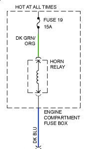

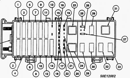

It shows light green in the diagram test that one also check your horn relay under the hood in the power distribution center. Relay #29.

I checked the light green wire in the 4 pin clockspring connector and there is no battery voltage with the ignition key on. There is battery voltage in a blue wire in the same connector. Also I switched the horn relay with the wiper relay and the wipers worked. When I put the wiper relay in the horn relay spot, the horn still did not work.

Test for power at the relay socket And check fuse #19 in the power distribution center.

In the power distribution box under the hood, fuse #19 is a 30A fuse and controls the headlights. Fuse #22 which is a 15A fuse is marked horn in the owners manual. The 15A horn fuse is good and there is power on one leg where the fuse plugs in. As for the horn relay, when standing in front of the car and looking down at the horn relay socket, there are 3 receptacles closest to the front of the car, one just above these three and one more above this one. The one farthest from the front of the car and the left one of the botton three have battery power at all times. If I use a jumper wire between either one of these hot receptacles and the middle receptacle, the horn blows.

Then either the relay or the switch on steering wheel are no good, or the clockspring you got was defective? Horn needs to work for cruise to work! Take clockspring back and see if they will give you a new one.
