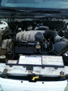

I fixed the over heating problem before and now it over heated so bad its not leaking no were and no water is in the oil and doesnt want to run but tries to ive checked the timing on it and its good and put a new coil pack on it what am i missing
http://www.2carpros.com/forum/automotive_pictures/536019_060510200259_1.jpg

Get a helper disconnect a sparkplug wire or 2 and ground it to the engine atleast 3/16 away from ground-have helper crank engine over-do you have a snapping blue spark? If so-you have a fuel related problem, check the fuel pressure to rule out the fuel filter/fuel pump/pressure regulator and listen to the injector/s are they pulsing or hook up a noid light. No snapping blue spark continue to troubleshoot the ignition system-power input to the coil/coil packs, coil's resistances, distributor pick-up coil, ignition control module, cam and crank sensors and computer Note: If it doesn't apply disregard it
