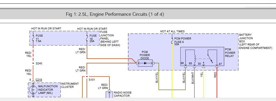

OCRIM504
  • 21 POSTS
While removing the instrument cluster I neglected to disconnect the battery. After reassembling everything I tried to start it but key turns on everything but doesn't turn the starter over. No selenoid click. Could I have shorted out a relay or fuse? I don't have access to a scan tool at this time. I did replace to check engine light bulb.
Friday, November 27th, 2020 AT 10:22 AM (Merged)
MHPAUTOS
  • 31,937 POSTS
Check the 3 fuses as shown in the pic supplied.
OCRIM504
  • 21 POSTS
I checked the fuses incicated and they are good. Code reader says no codes stored in memory.
MHPAUTOS
  • 31,937 POSTS
OK back to some basic tests, check for spark, injection pulse and fuel pressure and if you can get the fuel pressure reading at the rail.
OCRIM504
  • 21 POSTS
Can't perform those tests. When key is turned on dash lights light up and all accessories work however when key is advanced to start position the starter does not engage and no solenoid noise.
MHPAUTOS
  • 31,937 POSTS
With a test light check for power at the small solenoid wire at the starter with the key on crank and ensure that the battery connections and main starter cable is tight and clean.
OCRIM504
  • 21 POSTS
Checked for power at solenoid with key in crank position. No power!
MHPAUTOS
  • 31,937 POSTS
Check the starter relay, at the battery junction box l.H rear of engine bay
OCRIM504
  • 21 POSTS
Relays and fuses all checked ok.
Friday, November 27th, 2020 AT 10:23 AM (Merged)
MHPAUTOS
  • 31,937 POSTS
If all that is ok, you will have to look at the ignition switch and if that is working you will have to do a continuity test down to the starter or get an IDS or a quality scanner and see what codes if any are set.
