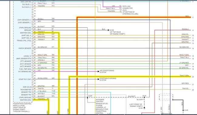

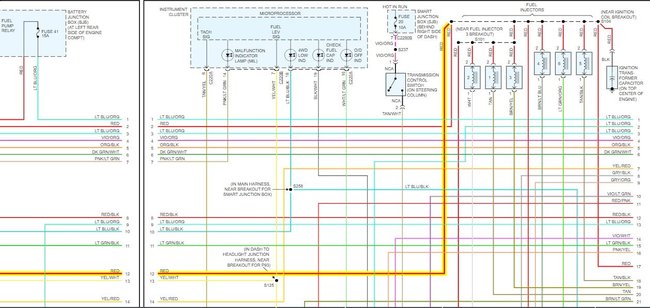

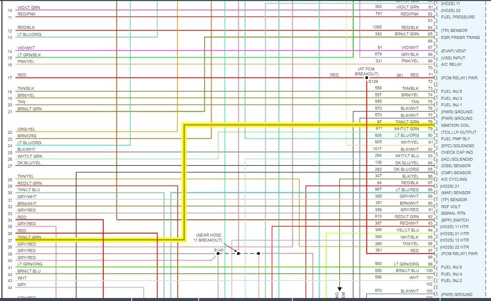

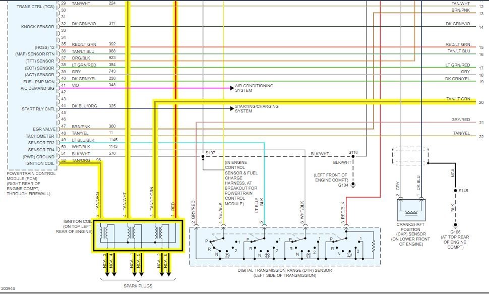

No spark on three and four when tested with HEI spark tester on coil. Have changed out coil pack, plug wires and plugs. Using procedures on easy auto diagnostics. Com there is no signal present on pin 1 per their procedure (no light flashing when engine started).
I would like to chase that red wire back to PCM, but would feel more comfortable with a diagram which shows the pin out supporting the ignition function.
Wednesday, July 29th, 2020 AT 10:53 AM (Merged)
  • 52,797 POSTS
Good morning,
I attached the diagram for you of the wires from the coil to the ECM.

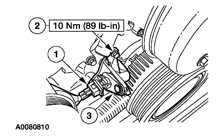

I would also consider the crank sensor. That is the sensor that sends a signal to the ECM for cylinder location and to ground the coil so the spark will occur.
and
Have you checked for any codes in the system? Do both the key on, engine off and the engine running check.
SAMELL50
Thank you Roy. After looking at the diagram, I figured out I am an idiot! Having a background in electronics I seemed to ignore what a red wire typically indicates (B+). So, my test had no value. I am going to start over and pull codes for key on, engine off and the engine running check.
I noticed the wire colors on diagram do not match those on my vehicle. Starting with red, next is white/orange, then white/green, and last is white/tan.
Little background: last issue was crankshaft pulley disconnected from crank hub. Pulley went way back toward block. Visual inspection did not show any affect on Crankshaft Position Sensor. Misfire started earlier this year when I was on interstate. Started sputtering, then MIL started flashing code for Cylinder #3 misfire and multiple misfire. Slowed down and it went to normal until I pulled a hill. Replaced fuel filter. Worked great around town, then when back when pulling on interstate same condition returned. I replaced the coil pack. Worked fine for a while, then started random missing with no code. So I replaced the plugs and plug wires. Now, last check was a cylinder 3 misfire.
I will check for current codes and get back to you. It does have a bad miss which I was trying to find. However, I connected to wrong wire to coil pack.
