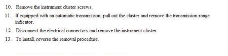

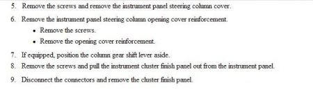

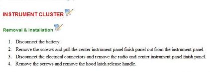

How can I get to the light to check it your are correct I did just purchase this pickup and now I am worried how can I fix the light
Friday, November 27th, 2020 AT 10:00 AM (Merged)
BLUELIGHTNIN6
  • 16,542 POSTS
You will have to remove the instrument cluster. i have posted the correct removal and installation steps below. once out, just twist the bulb to remove it and replace it.
https://www.2carpros.com/forum/automotive_pictures/261618_Noname_1143.jpg
https://www.2carpros.com/forum/automotive_pictures/261618_Noname2_330.jpg
https://www.2carpros.com/forum/automotive_pictures/261618_Noname3_123.jpg
