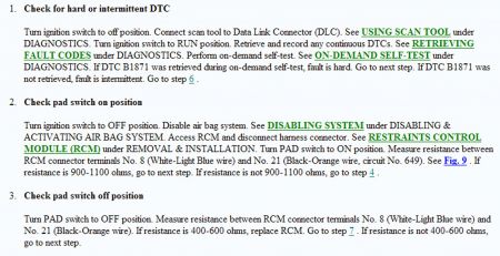

The air bag light was on. I was hit in the rear end. No significant damage and it went off.
Now there is a beeping noise fromthe dash. A series of 5 beeps and 5 times, so 25 beeps. Every fifth beep there is a slight pause.
Any ideas
Friday, December 28th, 2007 AT 5:39 PM
MERLIN2021
  • 17,250 POSTS

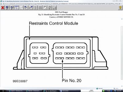

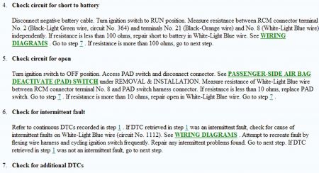

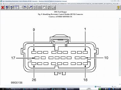

Flash code25=P1871 Passenger air bag deactivation switch fault. If you try to fix this yourself, Disconnect the NEGATIVE battery cable and wait 5 minutes before you service it.
