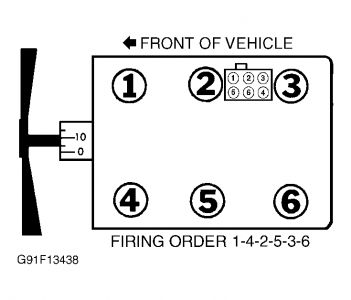

well we have a 1999 ranger witha 4.0 v6 that just wont run smooth, I checked to see what cylinders it was missing on, it infact was missing on the #3, #4and#6 cylinders I rplaced plugs and wires the coil pack is sparking strong this leaves me to believe that it is maybe a timing issue, I have made sure that the firing order is right, I pulled each plug wire off one at a time to find with ones didnt make a diffrence hince the missing cylinders I just cant pipoint what the problem is any help would be great
Wednesday, July 29th, 2020 AT 11:11 AM (Merged)
RACEFAN966
  • 5,029 POSTS
I would check injector as the coil fires two cylinders each. Meaning that the coil pack it wired as to fire two cylinders so it one and six are hooked together then you have both cylinders dead if there was a coil problem. Here is a pick of the firing order just so you make sure that it isn't wrong. Let me know how it goes.
