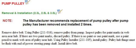

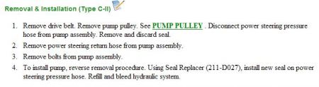

how do I get the power steering pump out of the ford ranger 2.5 1999

I can't get the pulley puller in between radiator and pulley on power steering pump, anybody have suggestions

Remove the shroud or shroud and radiator together to gain enough room
