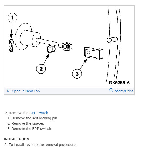

Hey guys. My tail lights are working, but my brake lights are not. I checked all the fuses and they seem to be fine. So I suspect the brake light switch. Where is the brake light switch located im told its above the brake pedal but I see nothing that even resembles a switch.

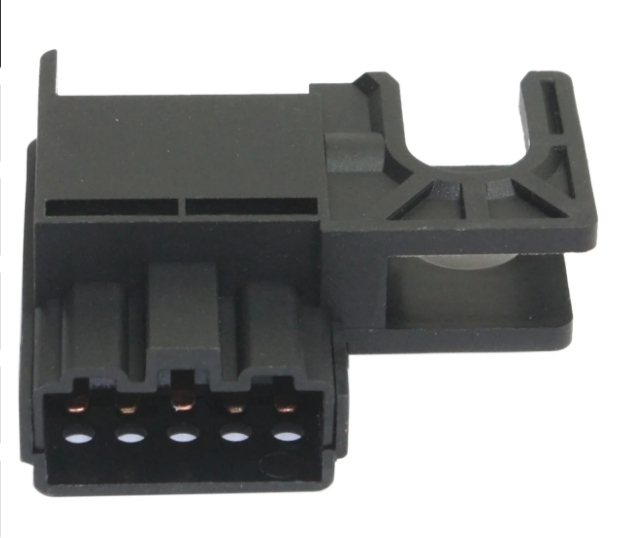

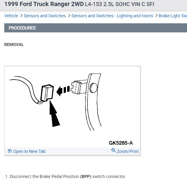

The issue does sound like a faulty brake light switch.
The brake light switch is located under the brake pedal lever. It does not look like a traditional switch.
https://youtu.be/RBCDVfzNQGk
I have attached the picture of the switch as well as replacement procedure.
