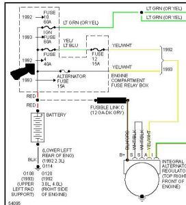

I Have replaced: Battery, Altenator, Alt. Field 15 amp fuse(Underhood fuse box) 30 amp fuse in pass. Comp, cleaned Batt. Cables & Batt. Post, all cables connecting to starter solenoid on fenderwell underhood, and it STILL isn't charging while engine is running. Can anybody help?
Thursday, December 10th, 2020 AT 8:42 AM (Merged)
DAVE H
  • 13,384 POSTS
Use a voltmeter red probe to alternator B+ connector and black probe to a ground .. you should be getting 13 + volts with engine running @ idle if oyur not alternator is bad still ... have you checked the fusible link in cable from alternator to battery !

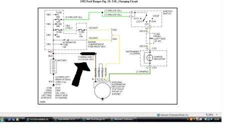

P-COLAVETTE
Yes, I have checked fusible link, it's good. I am beginning to think that the "Exciter" wire which supplies 12v to the alt. Is not doing it's job. If you can help me fix this problem, I will make a donation to the board, however, I believe in payment after service has been successfully rendered ! Thank's, Steve.

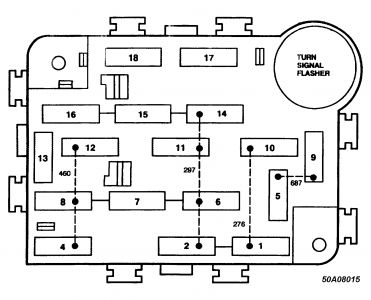

DAVE H
  • 13,384 POSTS
Check fuse #4 in underhood fuse box ..
https://www.2carpros.com/forum/automotive_pictures/266999_fuse_19.jpg
https://www.2carpros.com/forum/automotive_pictures/266999_fuse2_6.jpg
Also do you have a voltmeter ?
+1
P-COLAVETTE
Thank's All for the feedback ! I took the truck to a local shop yesterday, and after much Head Scratching & Foot Shuffling, it was determined that the underhood fuse block was incorrectly labeled ! The slot that was labeled as being the 15 amp ALT. Field slot, was not. The slot directly across from it turned out to be where the 15 amp fuse needed to be installed to energize the ALT. FLD with the voltage needed to cause the altenator to charge ! She's charging like a champ now ! Once Again, Many Thank's, Steve.

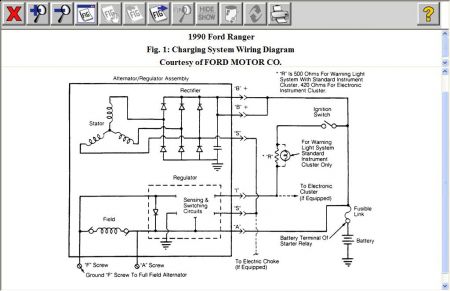

After replacing the alternator and the battery and serpintine belt vehicle still not charging and dash light for the battery is still on. And voltage meter only reading 10 volts
  • 75,992 POSTS
Double check all connection at battery and alternator if okay ground the F screw to full field the alternator if it increase doing this-replace the voltage regulator.
