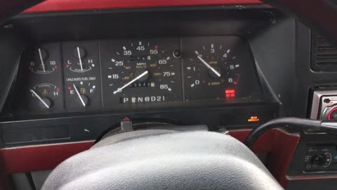

Can you make a quick video so I can see how the engine is running. You can upload it here in your reply. This way I wont have to guess.
-1
Tuesday, April 16th, 2019 AT 11:57 AM
LELAND'S RANGER
  • 5 POSTS
Here's the video. Hopefully this will help you :)
KEN L
  • MASTER CERTIFIED MECHANIC
  • 55,475 POSTS

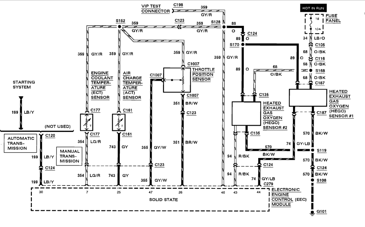

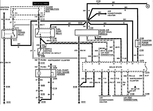

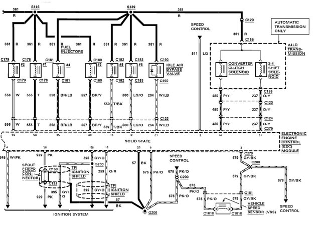

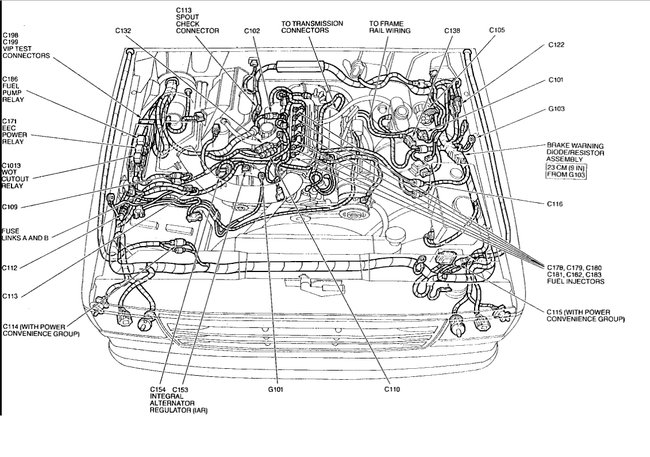

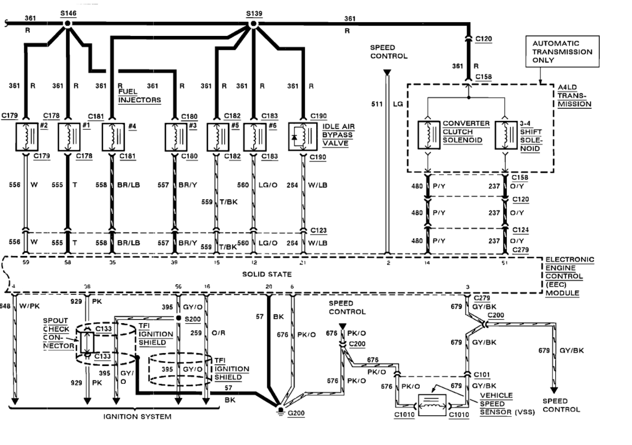

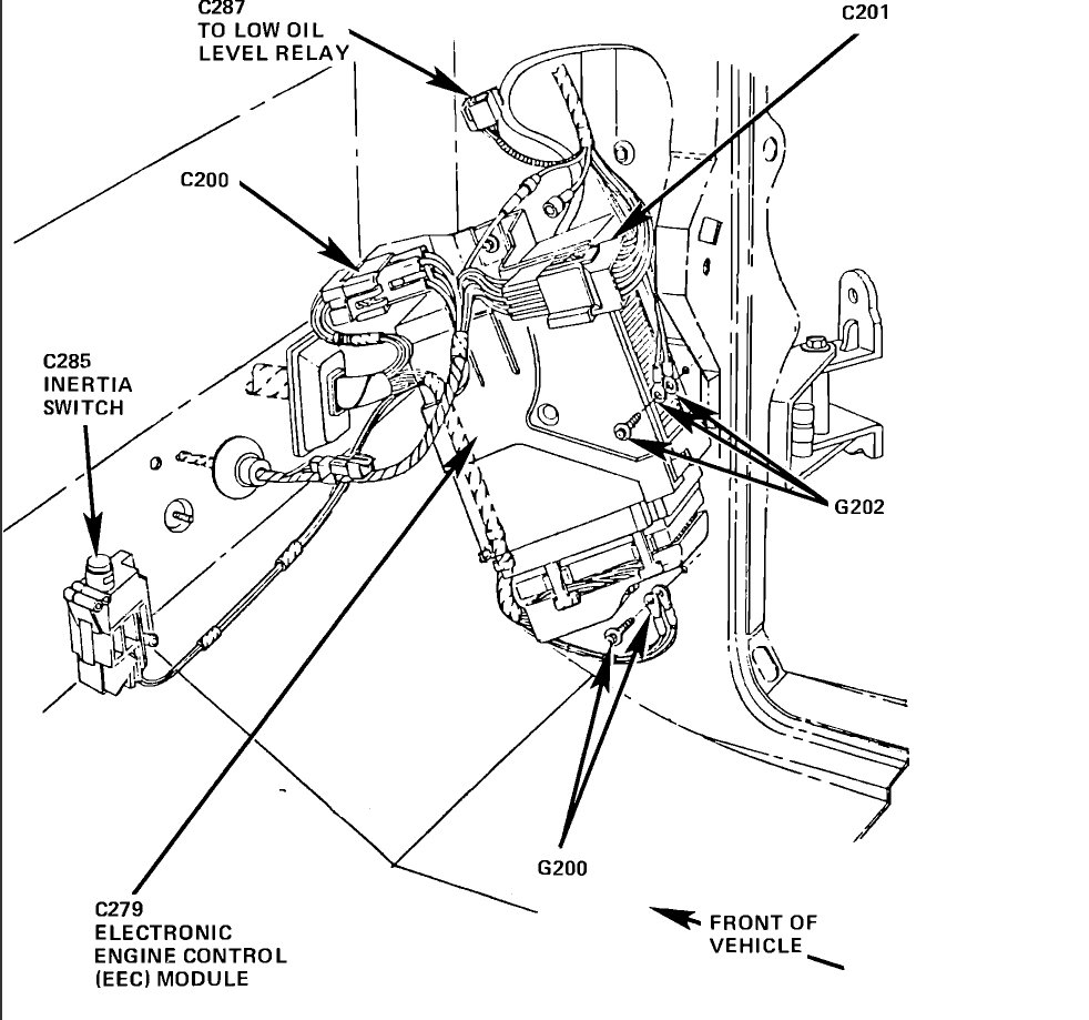

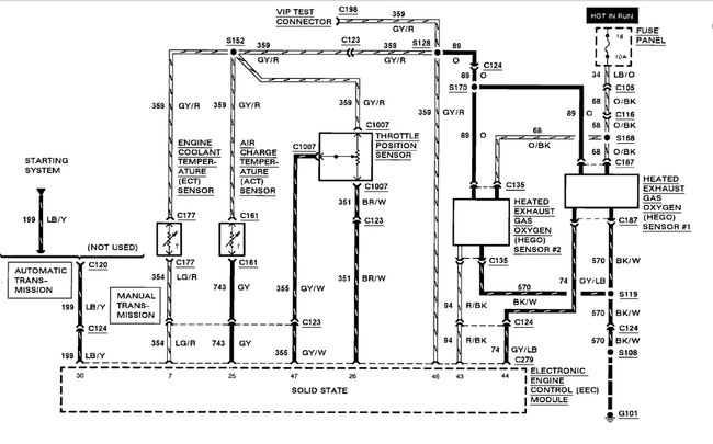

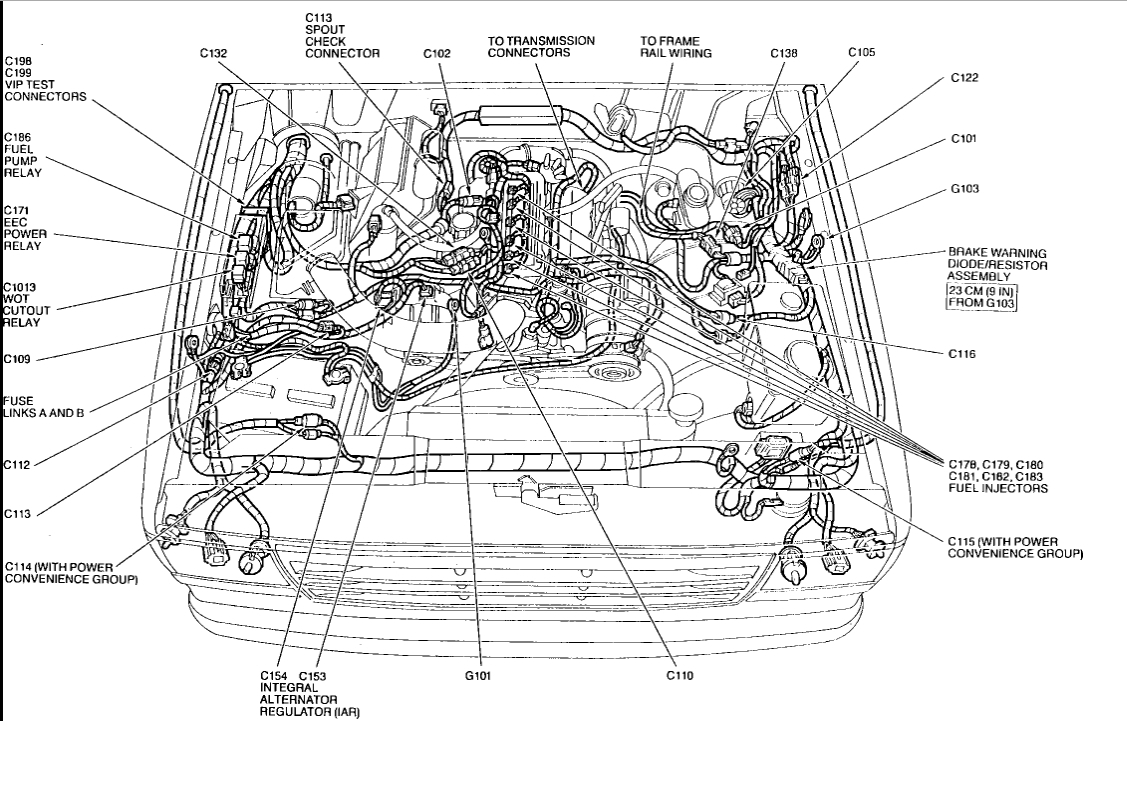

O ya, a video is worth so much, you see how the check engine light flickers, this is a sign of a couple things first is the system can have a bad ground or the ECM is out and needs replacement. Here is a guide so you can check the ECM grounds.
and
Here is the ECU location and the main system ground location as well. If the grounds check out you should be able to get a used ECM and plug it in. There is also a ECC relay I would swap out as well. Also check the battery cables they need to be clean and tight
Diagrams (Below)
Please let us know what you find. I'm interested to see what it is.
