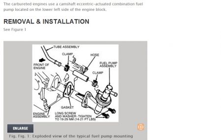

I just need to know where the fuel pump is located

My info shows carbed engine, mechanical fuel pump. The picture came from autozone.

The 2.3L engine should have 2 fuel pumps, one in the tank and on on the frame rail. If you have the carb'd engine than it will be a mechanical fuel pump mounted on lower left side of the engine block
