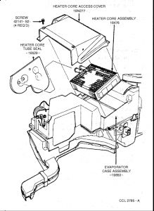

Looking for directions to replace heater core.

Heater Core
Removal:
1.Remove heater case from vehicle. See: Evaporator Case Service and Repair
2.Remove four heater core access cover retaining screws, and remove access cover from case.
Heater Core Removal
https://www.2carpros.com/forum/automotive_pictures/12900_h_1.jpg
3.Lift heater core and seal from case.
4.Remove seal from heater core tubes.
Installation:
1.Install heater core tube seal on heater core tubes.
2.Inspect heater core sealer in heater case. Replace, if necessary with Caulking Cord D6AZ-19560-A (ESB-M4G32-A) or equivalent.
3.Install heater core in case with seals on outside of case.
4.Position heater core access cover on case. Install four retaining screws.
5.Install heater assembly as outlined.
