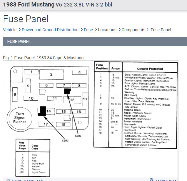

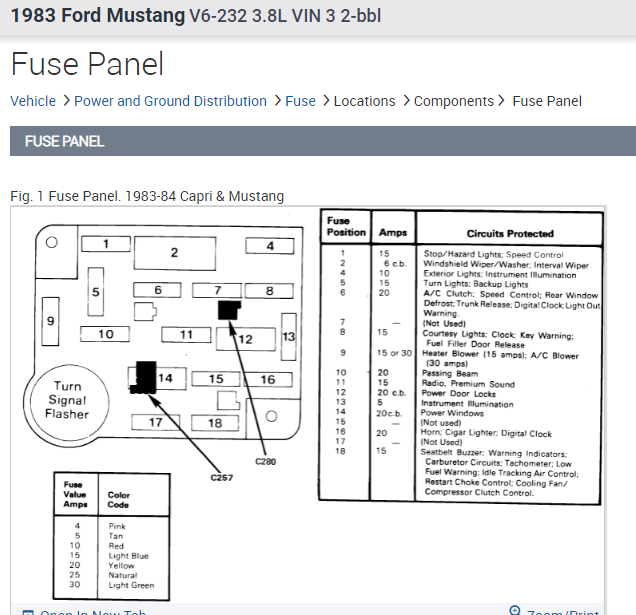

Good afternoon,
The fuse block location is listed below. It is under the left side of the dash.
Under Instrument Panel, to the left of the steering column.
I also attached the fuses and what they control for you.
Let us know if you have any other questions.

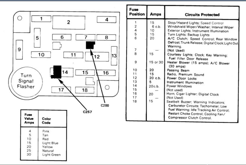

The fuse box is located under the left side of the dash, left of the steering column.
I have attached the fuse box diagram for your reference.
