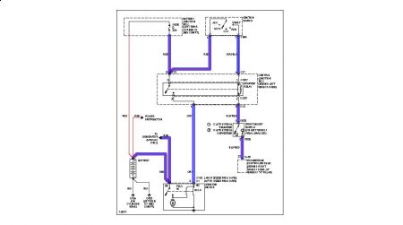

Car won't start tried jump starting
just get tick, tick, tick, sound
How do I check starter?

Load test the battery -if okay double check battery connections and at the starter.
Check fuse no.8 30amp if okay test the starter relay and start inhibit switch
