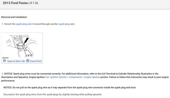

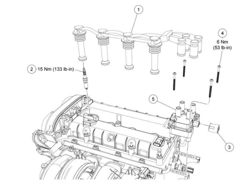

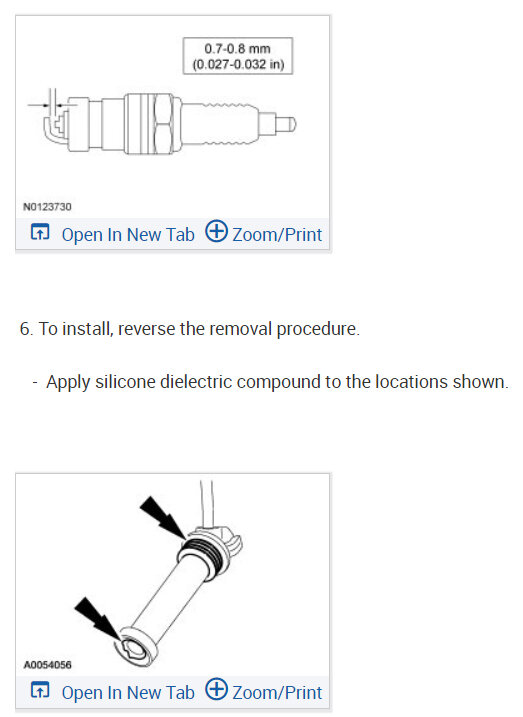

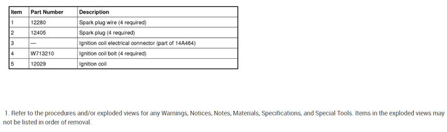

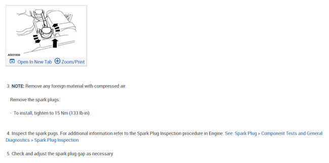

I don't see the video; can you please reload it? It can take a while over the phone so please be patient, also do you know the code number? You say the mechanic changed the coils but were the spark plugs replaced as well? If not, I would replace the spark plugs here is what needs to be done which makes sense because the check engine light will come on when the engine misfires.
Here is a guide to help as well:
Also, there is 1 ignition coil but 3 were replaced?
Removal and Installation
1. NOTICE: Spark plug wires must be connected correctly. For additional information, refer to the Coil Terminal-to-Cylinder Relationship illustration in the Description and Operation, Engine Ignition See: Ignition System > Components > Engine Ignition portion. Failure to follow this instruction may result in poor engine performance.
NOTICE: Do not pull on the spark plug wire as it may separate from the spark plug wire connector inside the spark plug wire boot.
Disconnect the spark plug wires from the ignition coil by slightly twisting while pulling upwards.
2. Disconnect the ignition coil electrical connector.
3. Remove the 4 ignition coil bolts.
- To install, tighten to 6 Nm (53 lb-in).
4. Remove the ignition coil.
5. NOTE: Wipe the coil towers with a clean cloth dampened with soap and water. Remove any soap film and dry with compressed air. Inspect for cracks, carbon tracking and dirt.
To install, reverse the removal procedure.
- Apply silicone dielectric compound to the inside of the spark plug wire boots prior to installation.
You should replace the spark plug wires as well. Check out the images (below). Please let us know what happens.
