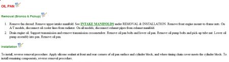

What is the trick to removing the oil pan I have a 5.8L engine 4x4 I have removed all the bolts and unbolted the motor mounts and jacked up the motor but the oil pan will not slide ouy. Please advise

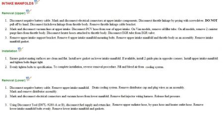

BLUELIGHTNIN6
  • 16,542 POSTS
https://www.2carpros.com/forum/automotive_pictures/261618_Noname_1866.jpg
https://www.2carpros.com/forum/automotive_pictures/261618_Noname2_593.jpg
https://www.2carpros.com/forum/automotive_pictures/261618_Noname3_231.jpg
+1
Tuesday, April 14th, 2020 AT 12:36 PM (Merged)

RICHZOMBIE
  • 173 POSTS
Yes, you will have to lift engine. Here is step by step how to replace oil pan.
https://www.2carpros.com/forum/automotive_pictures/307763_Noname_26.jpg
1.Drain the crankcase.
CAUTION
The EPA warns that prolonged contact with used engine oil may cause a number of skin disorders, including cancer! You should make every effort to minimize your exposure to used engine oil. Protective gloves should be worn when changing the oil. Wash your hands and any other exposed skin areas as soon as possible after exposure to used engine oil. Soap and water, or waterless hand cleaner should be used.
2.Drain the cooling system.
CAUTION
When draining the coolant, keep in mind that cats and dogs are attracted by ethylene glycol antifreeze and are quite likely to drink any that is left in an uncovered container or in puddles on the ground. This will prove fatal in sufficient quantity. Always drain the coolant into a sealable container. Coolant should be reused unless it is contaminated or several years old.
3.On 1987-93 models, remove the upper intake manifold and throttle body (see Fuel System ).
4.Remove the starter.
5.Remove the engine front support insulator to support bracket nuts and washers on both supports. Raise the front of the engine with a transmission jack and wood block and place 1 in. (25mm) thick wood blocks between the front support insulators and support brackets. Lower the engine and remove the transmission jack.
6.Remove the oil pan attaching bolts and lower the pan to the crossmember. Remove the two oil pump inlet tube and screw assembly bolts and drop the assembly in the pan. Remove the oil pan. Remove the oil pump inlet tube attaching bolts. Remove the inlet tube and screen assembly from the oil pump and leave it in the bottom of the oil pan. Remove the oil pan gaskets. Remove the inlet tube and screen from the oil pan.
