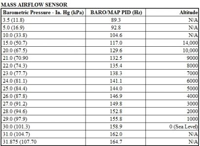

If anyone has or knows the graph the mass air fllows meaning kh\hr to 1-5 volts. I would like a graph it is a 90mm lightning mass air meter. Thank You.

If the maf reading in baro hz is not at or close to the specified value for the altitude you're at you have to assume the maf is faulty due to wrong readings
https://www.2carpros.com/forum/automotive_pictures/261618_Noname_2215.jpg
