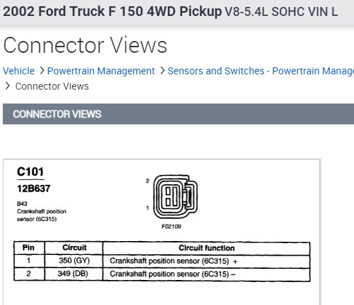

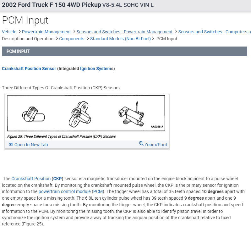

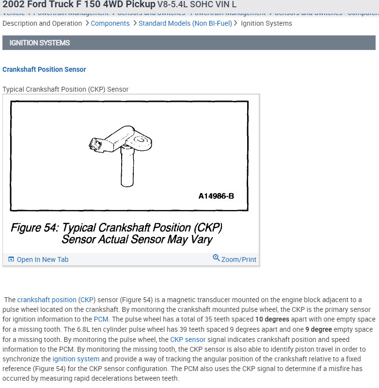

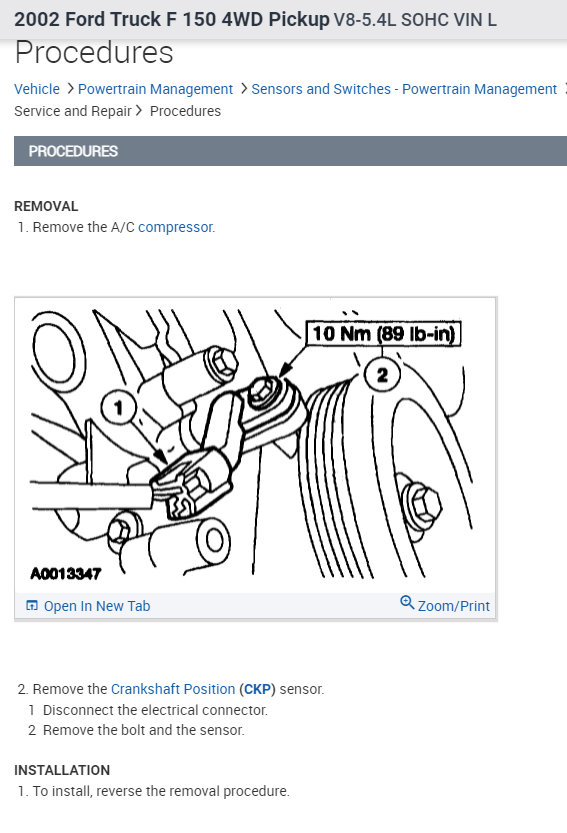

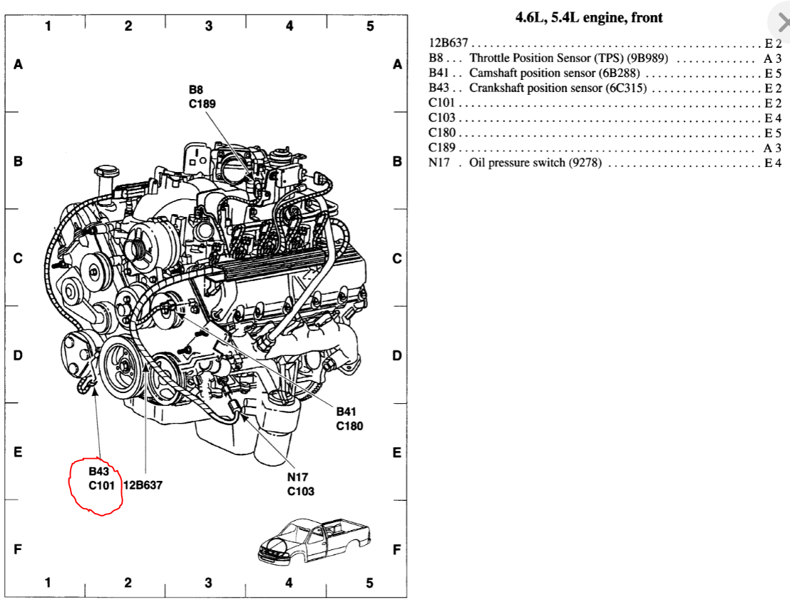

This sounds like an issue with the crankshaft position sensor.
Over time with heat and vibration from the engine the crank sensor can have internal malfunction. This will cause it to send error code to the ECM. And they ECM and shut the engine. This can happen at random times. After the engine stalls, you may or may not be able to get it start up.
The engine light does not always gets illuminated with a failed crank sensor.
The crank sensor is located on the lower front part of the engine. Next to the crankshaft pulley.
Here are some helpful articles:
https://www.2carpros.com/articles/how-a-crank-shaft-angle-sensor-works
