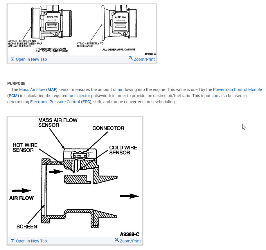

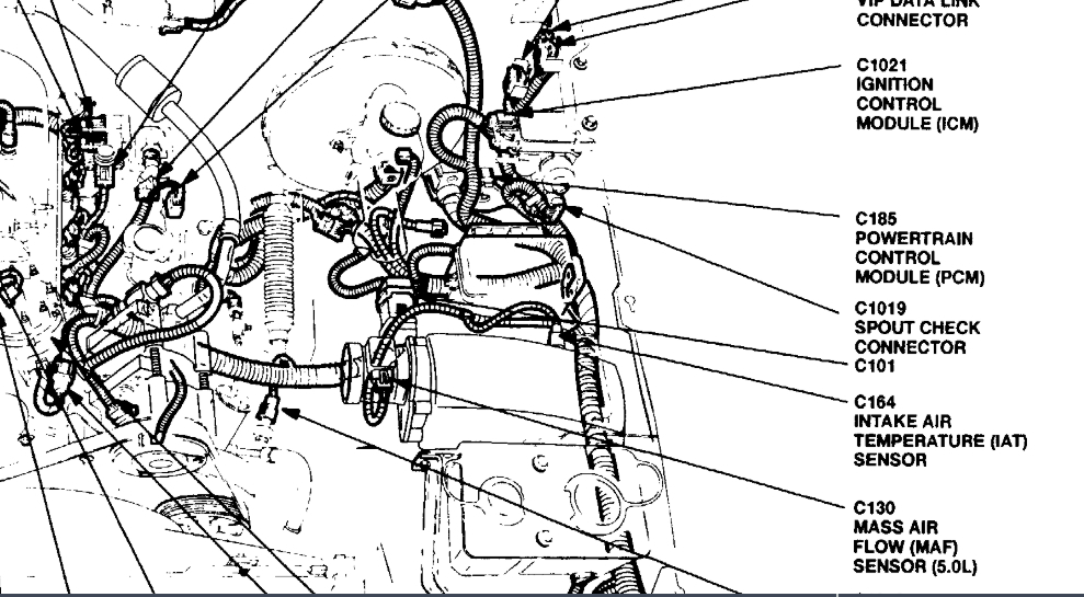

Ok it is an obd1 system and may not show any codes. What I would like you to do if you would is get some mass air flow cleaner (no other cleaner) and clean the mass air flow then start it and see if it idles and runs better. If it don't then unplug the mass air flow and start it and see how it idles, it will not have much if any throttle response so don't throttle it ok. Let me know how this goes. I will want to test the mass air flow sensor if it don't improve so you will need a digital multi meter.

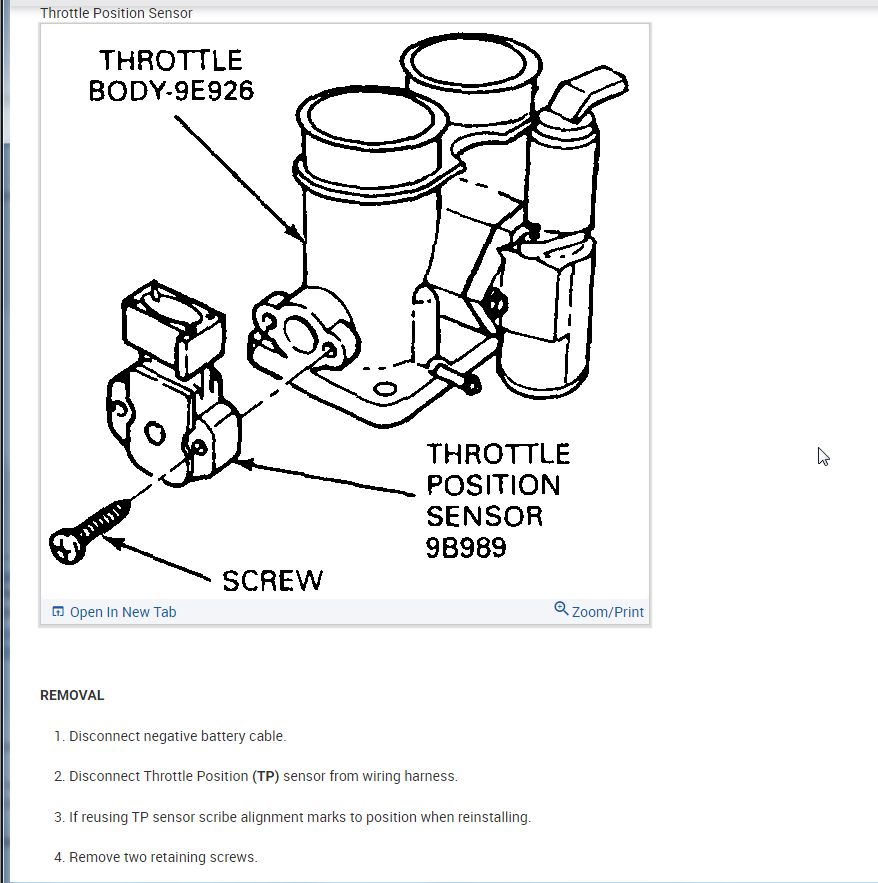

The truck was sitting out in the cold for about two weeks. We saw a leak in the heater hose which leaked into the throttle position sensor. We replaced the sensor and replaced the hoses. When we went to use the truck 10-30 minutes into running it at highway speeds we encountered power loss. It did not stall or quit running but it would go down in power to 20 MPH. Tried the overdrive switch and switching tanks with no improvement. We have replaced the computer , dropped the front tank and visually don't see anything but did replace the filer, which was not clogged . We put a new EGR valve and solenoid , distributor pick-up, EGR vacuum control, replaced all vacuum lines (used diagram under hood) also the exhaust manifold. We replaced the MAF but took it off as it even ran worse. We are at our wits end as this truck has never given us a bit of trouble except a pan gasket a couple of years ago. Any help greatly appreciated.
Jun 29, 2021 at 9:08 AM
(Merged)
I would suggest we need to start with checking for codes.
https://www.2carpros.com/articles/ford-lincoln-mercury-obd1-1995-and-earlier-diagnostic-trouble-code-definition-and-retrieval
Then we need to make sure the position sensor connector does not have coolant still in it. This will clearly mess up any electrical connection.

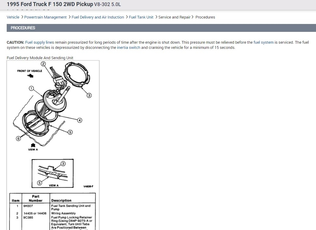

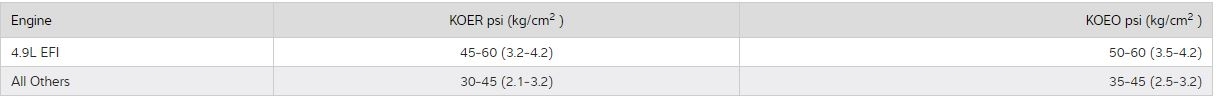

This could be the result of a few things. First, I would suggest checking fuel pump pressure when the engine is cold. If it is low, that can cause what you described.
Here is a link which discusses checking pressure:
I've attached a picture below which shows the factory specifications for fuel pump pressure on your vehicle. The acronyms, KOEO and KOER simply mean, key on engine off and key on engine running.
If you find the pressure is within the manufacturer's specs, next check for engine vacuum leaks. Remember, when metal gets hot, it expands. If there is an intake leak, warming the engine could lead to a smaller or no leak.
Here is a link which discusses how to check for a vacuum leak. Again, this should be done cold in your case.

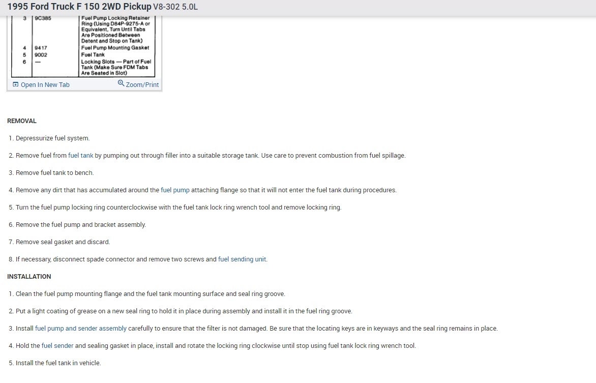

Good afternoon,
When it starts to run poorly, you need to test the fuel pressure. You may have a weak fuel pump that locks up when it gets hot.

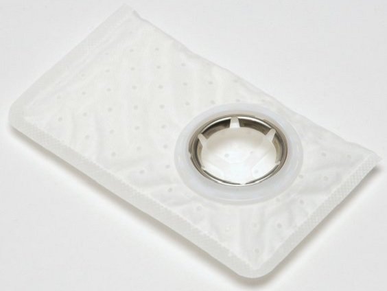

You offered a perfect description of the symptoms that occur when the fuel strainer inside the gas tank is plugged or is collapsing. This happened twice to my 1988 Grand Caravan at 200,000-mile intervals. In most cases with fuel-injected engines, the engine will run better at highway speed or when accelerating, and will tend to stall when the largest volume of fuel is being pumped, which is during coasting. Stopping the engine momentarily allows the screen to stretch out again to let fuel pass through it.
It is well-known that Chrysler fuel filters typically last the life of the vehicle, and you'll rarely solve a problem by replacing them. It's exactly the opposite with GM vehicles. Those are an easy fix for many running problems. I'm not aware of any such history for Ford vehicles, so you might want to replace your fuel filter first. Next, the way I identified this on my van was to connect a fuel pressure gauge to the fuel rail under the hood, and run the hose under a wiper arm so I could watch it when the stalling occurred. I found the pressure to drop from a normal 45 - 50 psi to as low as 20 psi. The engine didn't start to sputter until it hit 15 psi. Most engines won't even run with fuel pressure as low as 30 psi. I also found pressure would pop back up to normal if I just lifted the accelerator pedal for an instant, then it took a good 20 - 30 seconds to slowly drop again.
Here's a photo of the fuel strainer. It's snapped onto the bottom of the fuel pump housing in the tank.
