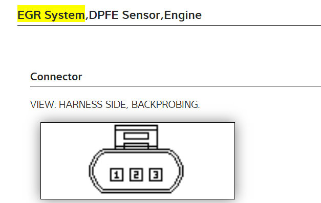

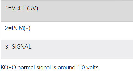

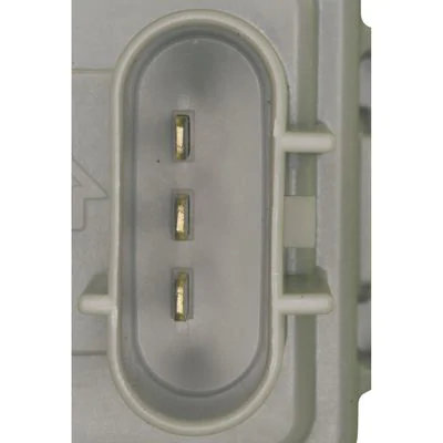

Which pin am I looking at for voltage change?
Monday, January 11th, 2021 AT 10:14 AM (Merged)
SCGRANTURISMO
  • 4,897 POSTS
Here is the DPFE Connector and the pin assignments.
Thanks,
Alex
2CarPros
WHITESHIRTSAMMY
  • 60 POSTS
I have 1.1v on the brown/green wire with the key on engine off.
  • 52,797 POSTS
That is not something you can monitor with a voltmeter. You need to monitor it with a scan tool. A voltmeter is not fast enough.
