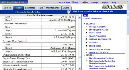

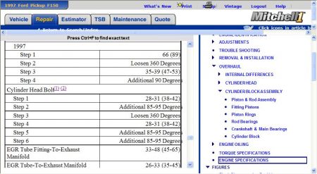

whats the headbolt tightening specs
Friday, December 19th, 2008 AT 12:14 PM
MECHANIC
75,992 POSTS
See below
4.6L
5.4L
