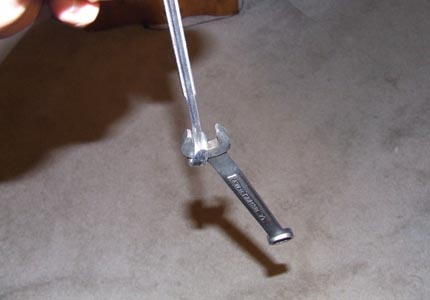

Locate the tensioner pulley, put a wrench on it and release the tension from the belt, remove belt, reverse the proceedure to install, I use two wrenches together for extra leverage...
