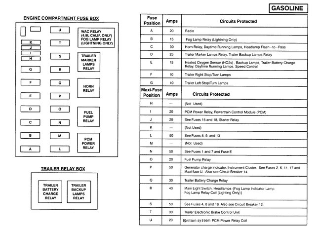

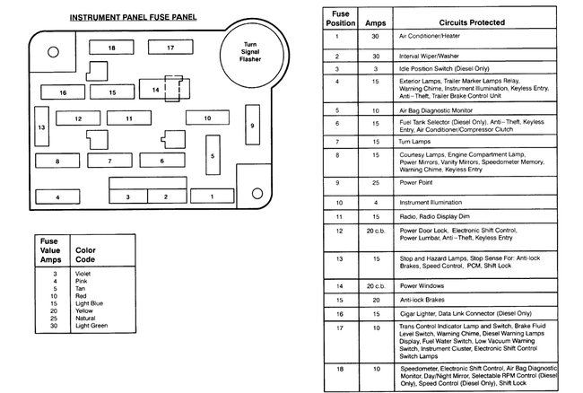

Im trying to find a diagram for my Power Distribution box, dont have owners manual so I cant see it.

Here is a guide to help you test the fuse with the fuse location and identification below.
Images (Click to make bigger)
