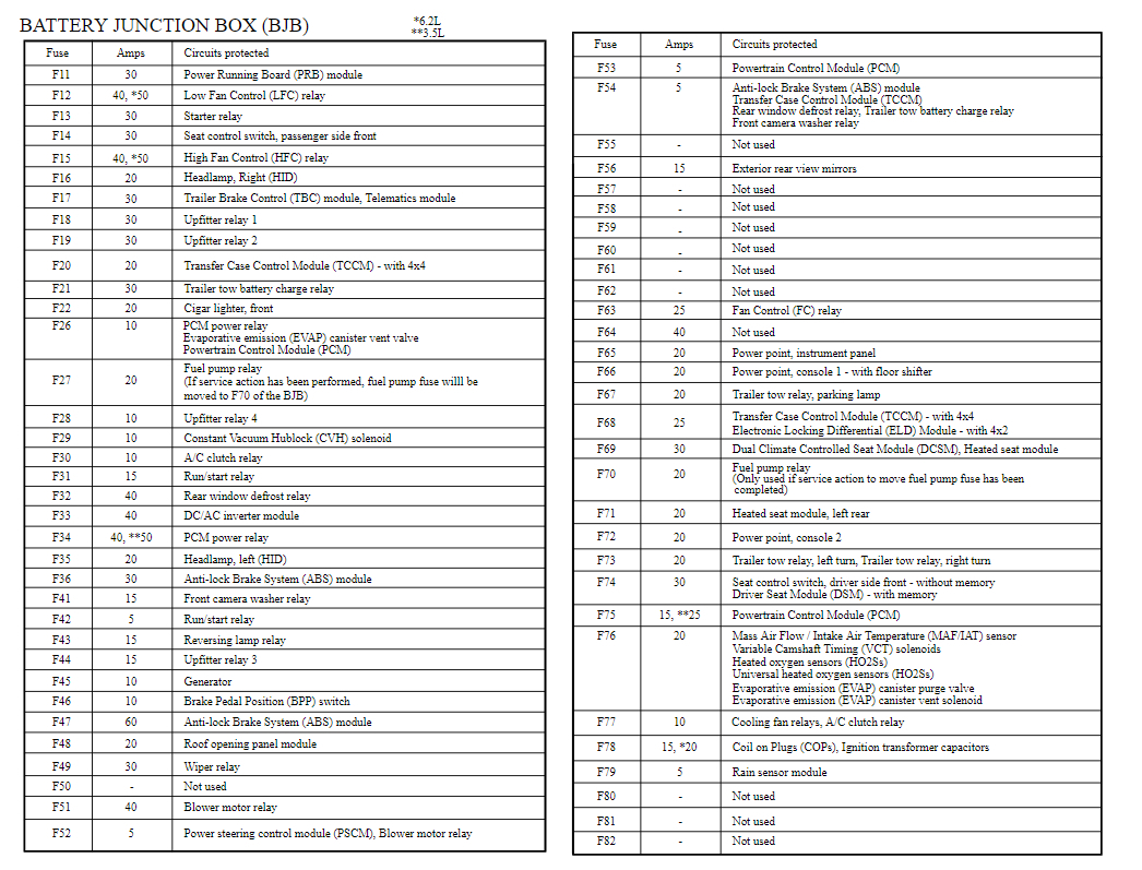

fuse panel location large plug attached to the top of fuse box

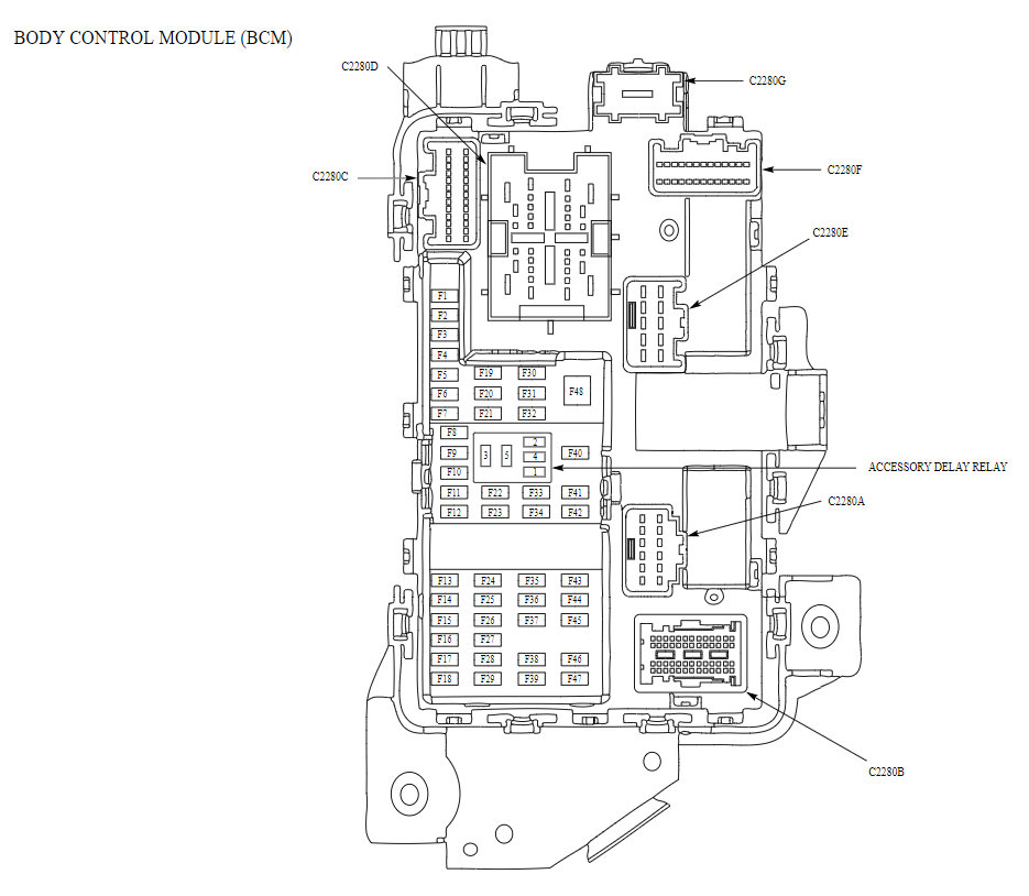

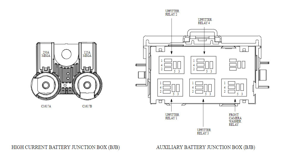

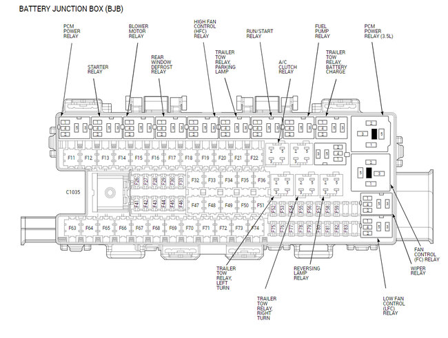

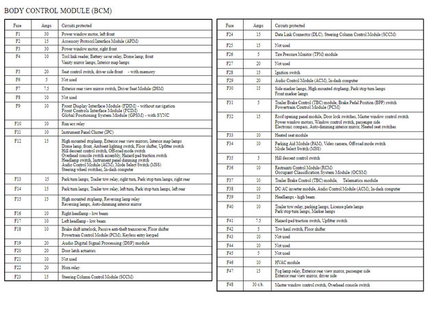

What needs to be done with the large plug attached to the top of fuse box it's not getting a good connection and have to push it in and hold it and nothing is broke I need to know the fuse locations and what they run?

Here is a guide to help you check the fuse with the fuse panel location and identification in the diagrams below.

if a fuse has to be replaced how would you do it disconnect battery?
Mar 23, 2016 at 8:05 AM
HMAC300
  • CAR REPAIR CONTRIBUTOR
  • 48,601 POSTS
you should be okay with the battery connected.
