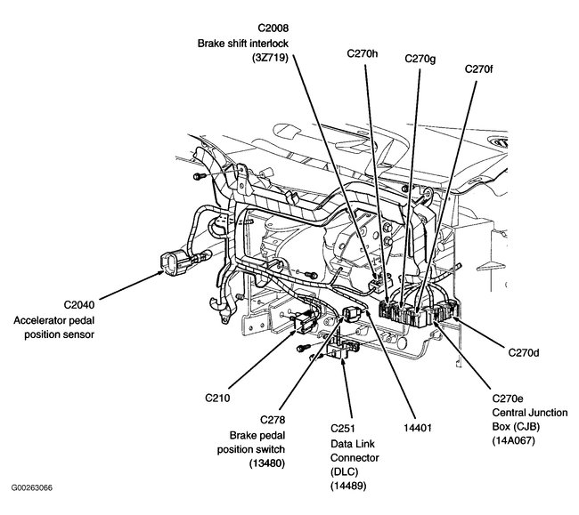

HARRY P
  • 2,293 POSTS
Well the proper way to do it would be to hook a scanner up to the data link connector port (below the dash, trapezoid shaped, see attached image) and have the scanner erase the code(s). You might as well get the trouble codes and write them down so we can diagnose the issue. You can buy an OBD2 scanner from Amazon or eBay for pretty cheap, or you can go to AutoZone, Advance Auto, or O'Reilly Auto Parts and have them scan and clear it for you. They do this for free. Also, here is our guide on the check engine light, which includes how to scan for codes: https://www.2carpros.com/articles/checking-a-service-engine-soon-or-check-engine-light-on-or-flashing
The other option would be to disconnect the positive battery cable and touch it (the disconnected cable) to any ground or the negative battery terminal for about ten seconds. This will ground out any residual energy in the system and reset all of the computers (including the one with the codes).
