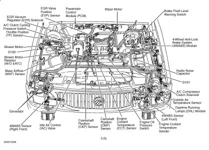

1999 Ford Explorer V8 Two Wheel Drive Automatic 150k miles

When i said i replaced the whole EDIS system, i also replaced the crank sensor after it tested bad. ring is good cond still. the 5.0l has really no vaccum lines, all ready checked them. Wouldn't the egr system throw a CEL regarding the evap?

Cam sensor replaced also?
https://images.2carpros.com/forum/automotive_pictures/198357_Graphic_316.jpg

The crank is the cam sensor on this one i believe, compression tested the number 6 cylinder last nite and found nothing out of the ordinary. above 150psi. might try a leak down today, looking for maybe a possible bad valve. Since they seem to always had bad valves since forever.

Leak down good idea there is a camshaft sensor top front engine
https://images.2carpros.com/forum/automotive_pictures/198357_Graphic_319.jpg

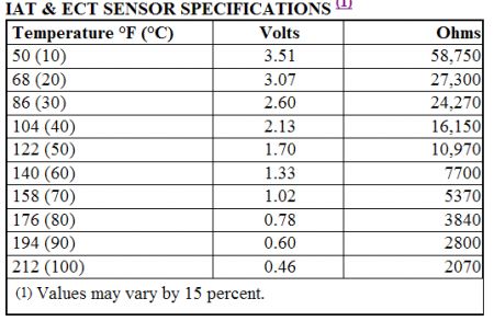

the man at the auto advance store could not remember the code and he said he erased it but he said it meant or said "close fuel control" - temperture koolant low. he put some in but it was such a small amount that would even go in.
thanks
pat
Jan 6, 2021 at 2:17 PM (Merged)
MERLIN2021
  • CAR REPAIR CONTRIBUTOR
  • 17,250 POSTS
Maybe this one?
https://images.2carpros.com/forum/automotive_pictures/62217_IATECTTesting_1.jpg
https://images.2carpros.com/forum/automotive_pictures/62217_P0125_1.gif
Test both ECT(engine coolant temp) and (Intake air temp) sensors with an ohm meter, readings should be as in the chart above, some IAT sensors are built into the MAF(mass air flow) sensor. Most common and cheapest is the ECT about 20.00! ECT is on left front of engine in front of the throttle body.

Can be either one, but it is most commonly the ECT...you do need to test it as I said Pat...If the thermostat is weak or staying open constantly, it can do this as well...Remove the tstat, boils in water with a thermometer, dont allow the tsat to rest on the bottom, when it opens, take note of the water temp, if it's at the rated temp 195, then it good. If it opens earlier, it's not, or use a hand heal infrared themometer aimed at the thermostat housing, does the engine ever get to 224? The thermostat couldnt have been too much money, if you already have it, install it, and see if the light goes out after it warms up...Book calls for testing the sensors, but temp is temp!
