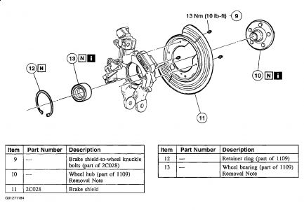

How do I replace the rear wheel bearing and hub assembly on my 2003 Ford explorer

Remove tire
remove brakes
remove rotor
remove parking brake shoes
remove wheel bearing hub
