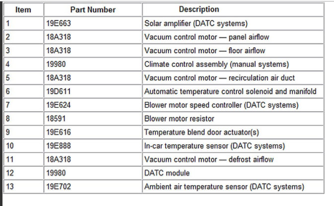

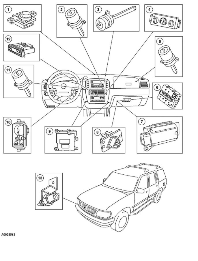

It sounds like the mode actuator is bad. here is guide to give you an idea of what you are in for when doing the job. Also some of the air doors are power by vacuum so check the vacuum lines under the hood to make sure they are not falling apart.
and
https://www.2carpros.com/articles/air-vents-stay-in-the-defrost-position
and this guide and video can help as well.
and
https://youtu.be/SNRb6pSwYuU
Check out the diagrams (below) Let us know what happens and please upload pictures or videos of the problem.
