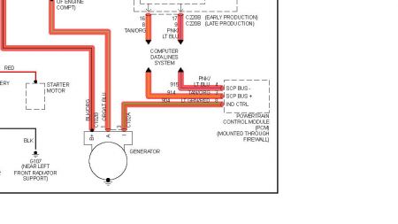

Could be a problem with the computer controlled field generation of the alternator-
https://www.2carpros.com/forum/automotive_pictures/12900_alty_20.jpg
