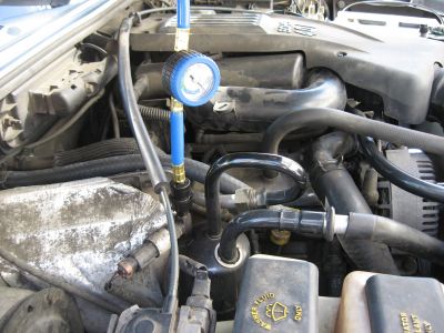

I tried adding refrigerant but the gauge goes all the way to the end of the red and it won't take any new refrigerant.

This sounds like you have an AC compressor that is not working which is common do you see the clutch turning? If so here is a guide to help you replace the compressor and recharge the system.
https://www.2carpros.com/articles/replace-air-conditioner-compressor
and
Please run down these guides and report back
Cheers, Caradiodoc

Yes it is turning. I followed your guides and got a new compressor from Amazon for $178.00 and fixed it myself was not that hard. Here is me adding Freon. Thanks again for your help I love this site.
