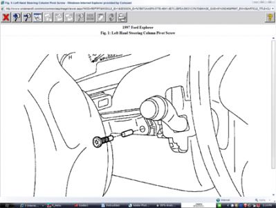

Not a good idea to remove the boots! only an experienced mechanic with the tool to put a new boot clamp on should do it...I will tell you, not being able to hear it, it's hard to diagnose, that said if it is a clunk, that usually involves either a motor mount or an inboard cv joint, called the plunger...you should have no play twisting or pushing and pulling. If the clunk is in only the steering whell there is a tech bulliten about it, here's the fix for that.
https://www.2carpros.com/forum/automotive_pictures/62217_Clunk_Fix_1.jpg
-1
Friday, April 18th, 2008 AT 2:23 PM

He again, thank you for that, though I cant quite make out what it is. Where can I either see that on the net or you you be able to tell me where I can get the parts needed and where that was pointing to put it. Thank you again, I sure hope this helps
Friday, April 18th, 2008 AT 5:21 PM
MERLIN2021
  • 17,250 POSTS
That's the steering wheel, and under the cover on the left side ONLY! Do not remove both sides! Part is available at ford dealer. It's just a piece of plastic that goes in before the screw to take up slack. Sorr the part number was cut off, and I will need to look it all up again, will get to it in the am.

MERLIN2021
  • 17,250 POSTS
Bulliten # 98-14-5
Part number F87Z-3C549-AA Steering column spacer
time to install 0.3 hr.
