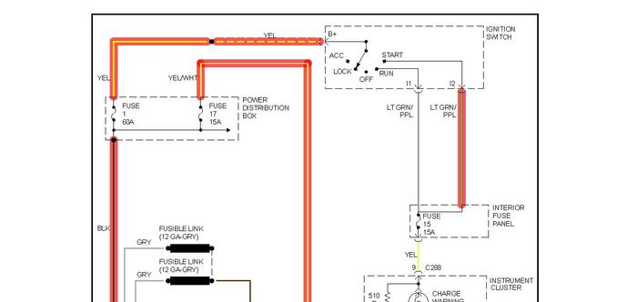

Electrical tests indicate that the battery is good and the alternator is charging steady at 14V. Intermittent alternator fault suggested. Battery indicator on dash is good at half way. When stationary and rev sharp up to 4-5000 rpm and then throttle released engine drops down to near stalling with battery meter going right down only to quickly correct back to normal. Lights and radio lights dim when hits near stalling. Recovery almost straight away. Mechanic suggested slight leak on the manifold area explains 'popping' noise and an electrical fault will screw up the ignition. Also indicated that an alternator fault would cause the vehicle to behave erratic as described. Seeking electrical mechanic Monday. Any advice as to fault greatly welcomed!

Thanks Medic. Read about disconnecting the battery to reset the computers might help. And the erratic gauges sounds right. Also just reading up remember smelling a hot smoldering plastic smell after drives. I thought it was normal on these Big cars (Im used to 2 litre alfa romeos in the UK!), But turns out it can be erratic charging from the alternator if bad connections or diodes gone causing an AC leak into the DC circuits. I think we're onto the fault here but still appreciate everyone's thoughts and input! Going to check the wires in the morning as lost the light now and maybe replace the alternator if the connections are good. BTW, lol on the call for help. I always get that from the family members in the UK. And you can do tons of work on an engine but it'll be the cheap new wing mirror that brings the wow face. Doh!

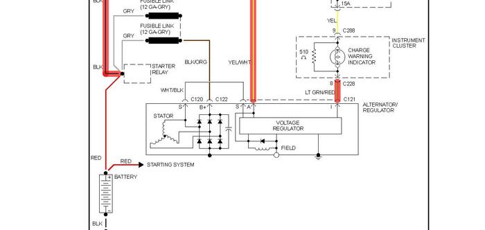

You started a big war I was going to cut it short due to circumstances-But No-you choose to send it to the grave-lol
Here's your Charge System-EWD now you can test it
Friday, October 9th, 2020 AT 11:39 AM (Merged)
FROHIKE47
  • 6 POSTS
Electrical Mechanic gets back to me indicating that its all down to the Over Drive (O/D). The O/D hasnt worked since I got it and not to familiar with it on the automatic gearbox. Numerous little things have gone like bulbs in the dash but apparently its to blame for everything? Cheap repair anyhows and cheaper than an alternator or transmission thats for sure! We'll see how it goes. Thanks to all for help and especially for the wiring diagram!

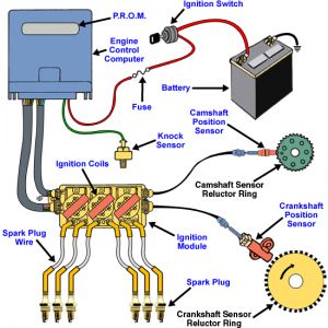

Engine stalls after about 30 minutes of running. Seems like when engine and componets are warmed up that is when it stalls. It will not restart for about 45 to 60 minutes later

When it won't start, have you checked to see if the engine is getting spark and fuel?

Yes I can hear the fuel pump and know there is no spark when this happens. I actually removed the coil pack to cool it down just in case it might be it but as far as it getting hot and not working, this is not it. If it has no spark should I still check for fuel

  • 110,194 POSTS
No, if there is no spark, that is why it won't start. Chances are it is a bad crank sensor, but has the check engine light come on? Also, are you sure the fuel pump is turning on? The EEC relay will sometimes shut everything down, but if you hear the fuel pump, that isn't the problem.
