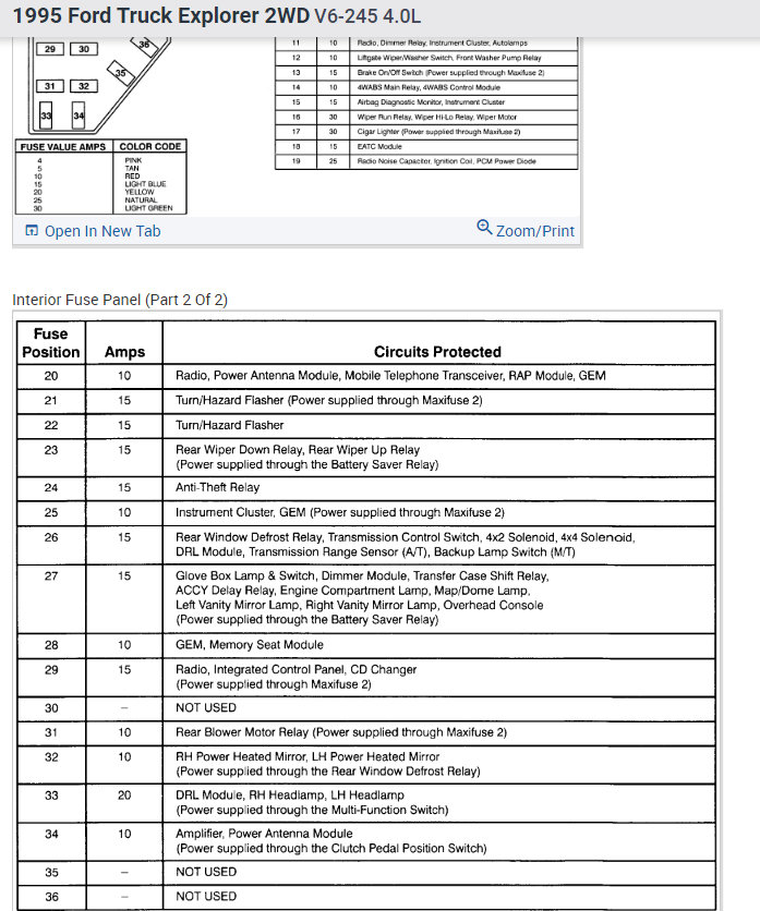

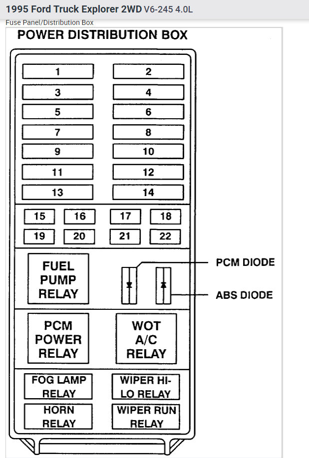

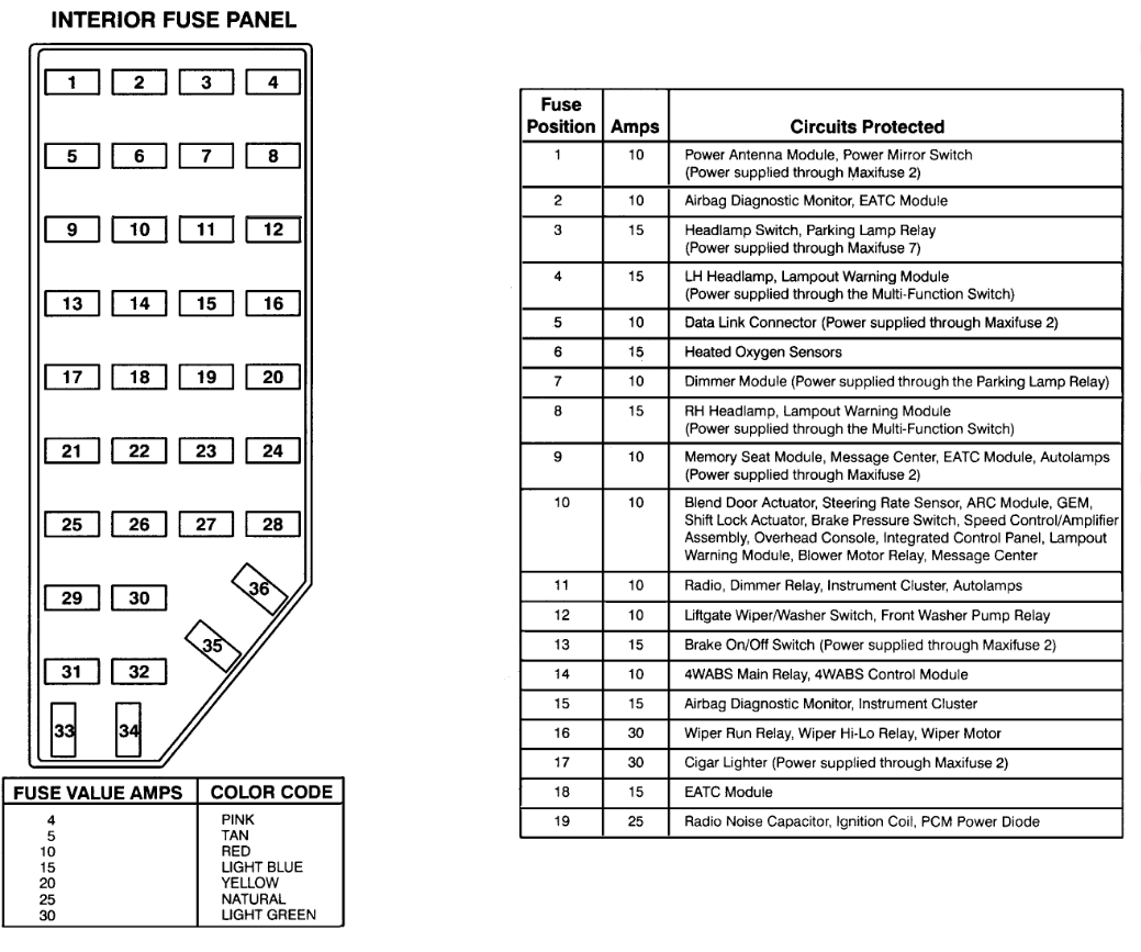

I need a fuse box diagram for my truck?

This vehicle have two fuse boxes. One is under the dash, other is located under the hood.
I have attached fuse diagrams for both.
