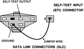

OBXAUTOMEDIC
  • 3,711 POSTS
Thank You for the Donation....
Since engine light came on there is most likely a code set. You will need to pull codes...
Here's How.....
To extract DTCs from the computer for diagnostic purposes, the Self Test connector is used. It is located in engine compartment on drivers side on fender well.
1.Start engine and bring to normal operating temperature. If engine will not start or stalls after starting, proceed with next step.
2.Turn the key "OFF", then wait ten seconds.
3.Activate the self test by grounding the Self-Test Input (STI) connector.
4.Turn the ignition key "ON". Engine Light will Flash codes.
5.Record all codes received.
6.Turn ignition "OFF".
https://www.2carpros.com/images/question_images/199407/original.jpg
The following is how to read flashes...
Codes will be 2 digits.....
Flash short pause flash long pause = code 11
flash short pause flash flash would = code 12
flash flash short pause flash would = 21
and so on.
Post codes back here in forum.....

The OBD reader said 542 Fuel pump circuit

The code indicates a bad ground somewhere between the PCM and the Engine. So you will need to check the grounds.

Ok, since the code you posted is 542 and the Code Def is Fuel Pump Circuit Open - PCM to Motor Ground, that indicates a ground problem. It could also be a Bad PCM.
There are only a few wire to check and since it is in the Fuel Curcuit through the PCM all you should have to check is the PCM Case Ground and the FPM Ground.
Look at the diagram for you engine size.
Remove the Harness to the PCM Find the Color Coded wire for the PCM Ground #20 in both Diagrams. Find grounding point and use Ohm Meter to test.
Then look for the FPM #8 in both diagrams and they are both the same color code Dark Green with Yellow Stripe. Use same proceedure as above to test.
