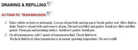

My transmission fluid is black instead of pink and it shifts a little slow. Could it be my filter? If so how do I change it? Also, how do I drain the old fluid so I can put new in?
Thursday, August 2nd, 2018 AT 7:15 PM (Merged)
BLUELIGHTNIN6
  • 16,542 POSTS
Could be dirty filter and burnt up fluid, yes.
https://www.2carpros.com/forum/automotive_pictures/261618_Noname_1031.jpg
