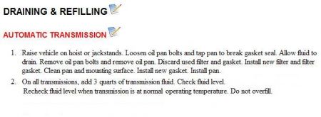

The total capacity of the transmission is twelve quarts. How much you need to add depends on how much is already in the unit. Your best guide is the indicator on the dipstick. Level should be between the "add" and "full" marks on the stick with the engine idling in park and transmission warmed up to operating temperature.
Here is a guide to help you see how to do the job:
Cheers
