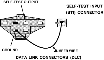

My 1994 ford explorer runs fine and then it stops running and all the power to the truck goes. We have tried the spark plugs and the cam position sensor and then we tried to replace the computer. And it still does the same thing. Do you have any idea what the problem could be?

I had a similar problem with my 93. It turned out to be a faulty PCM relay. I would be driving along and the engine would die. After a minute, it would restart and go for a while. It is located in the power distribution box under the hood. Check with your owners manual for the location.

What you are describing is indicative of an electrical component getting hot and failing. Often in the ignition system like a control module or coil.
Next time you get home after a drive and have some time to mess with it, try to restart it. If it wont start, pull a spark plug and verify that you have a good spark.

I need you to check something. On the 94, there is a relay called the Electronic Engine Control (EEC). I have experienced people with the same vehicle saying they drive, it runs fine, they stop and it won't restart. If the relay is bad, it will shut down the fuel pump and spark to the engine. When it doesn't start, switch the EEC with another relay in the box that has the same part number. See if that fixes the problem. If it does, replace the relay.

It sounds like a crank sensor. Have you actually checked fuel pump pressure? I realize it is new, but there could be an issue with the regulator. Has the check engine light come on?

We got it fixed so anyone who is having same problem change out your crankshaft position sensor it fixed my problem and the part is'nt too exspensive $39 and change total at O' Reillys auto parts store. The sensor was'nt completly out it was weak so when it got hot enough it would cause truck to die.
