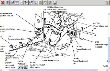

My daughter swerved to miss a deer and hit a tree. She was going about 40 mph. She hit right behind the passenger door on the drivers side. The expedition is dented in 2 in or so from the top to bottom. You can see a circle in the tree bark where the tire hit it. It bounced back about 3 feet from the tree. The back window broke out and glass went for about 8 feet. No air bags deployed. All of the doors are hard to open. It would not restart and could not be driven. Do you think they will fix it? What do you think the cost will be? I am a single mom and need some help. Thanks.

No air bags deployed. so much of protection huh! other than the door problem -find the inertia fuel cut off switch could have tripped its on that side see below C-4168
https://www.2carpros.com/forum/automotive_pictures/12900_inertia_cutoff_switch_1.jpg
