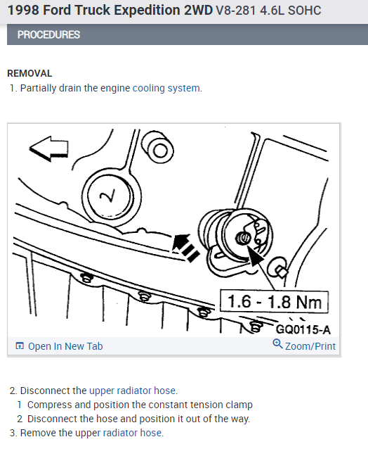

My heater will come on blowing hot for about 30 sec, then it turns cool. What could be the problem?
Friday, February 12th, 2010 AT 4:42 PM
SQM
MECHANIC
6,383 POSTS

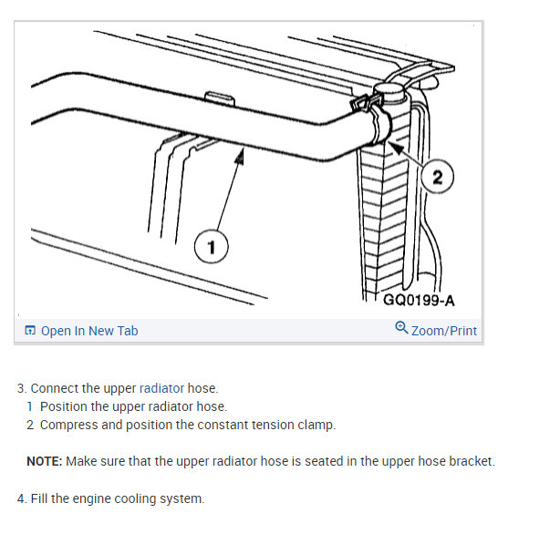

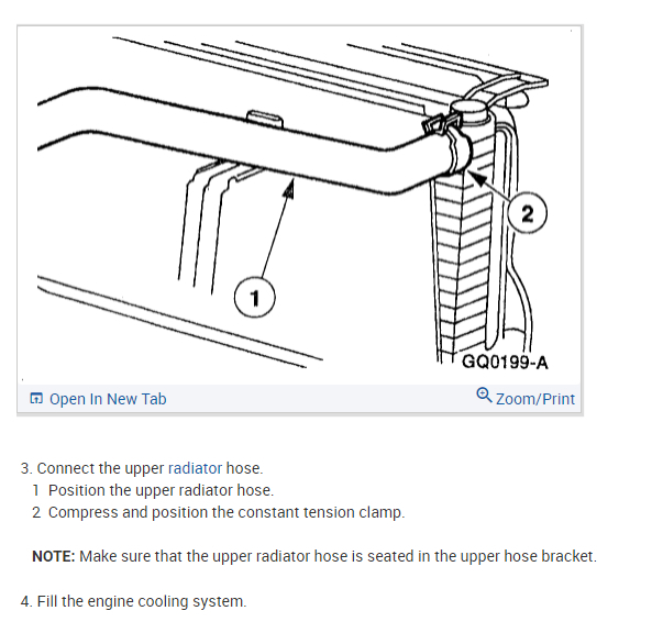

First check your coolant level. A low coolant can cause the heater to not function properly, as the coolant will not flow thru the heater core.
https://www.2carpros.com/articles/how-a-car-heater-works

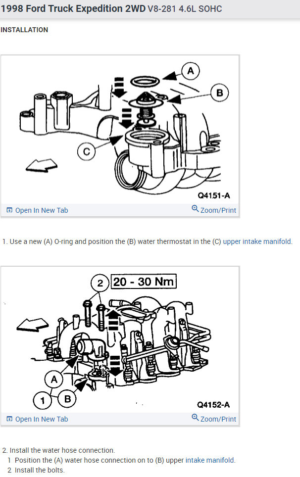

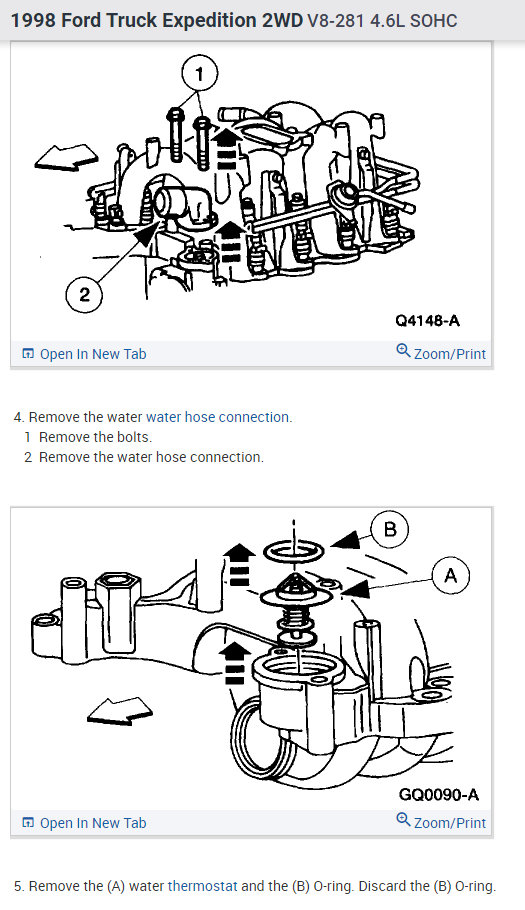

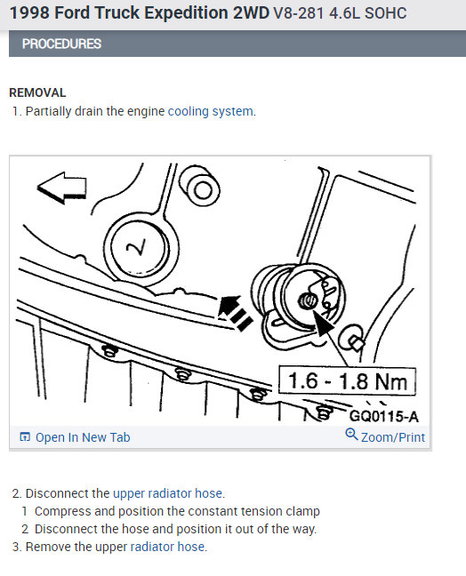

Another possibility is a stuck open thermostat. If the thermostat is stuck open then the engine will not reach the operating temperature and when that happens the heater will blow cool air.
https://www.2carpros.com/articles/how-an-engine-thermostat-works
