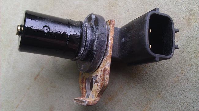

how do you get a speedometer sensor out
Climb under the vehicle and locate the speed sensor. The sensor is located on the bottom of the transmission, or it may be located on either side of the transmission housing. It looks like a small plug sticking out of the transmission with an electrical plug connected to its end.
Remove the electrical plug by squeezing the release tab on the top of the plug and pulling the connection apart.
Remove the sensor by turning it counterclockwise with an open-end or a crescent wrench.
Install the new speed sensor. Installation is the reverse of removal

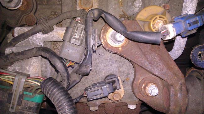

I changed the battery for my car and since then the speedometer/odometer quit working.
1. Could it be caused by something in battery change?
However, the engine check light is not on.
2. What could be the problem then?
I am not sure if the speedometer is driven by cable or just electricial VSS. How I could tell or get this information?
If I need to replace VSS, where is it located?
Thanks a lot.

Hi ldhljljq,
Thank you for the donation.
VSS is electrical and located on lower rear of transaxle, somewhere beow the throttle body.
The VSS should not be afffected by the battery change but if the speedomewter needle had overshot, then yes, it is caused by power surge. Returning the needle to its original position should work.
CEL might not show for such problem and the only way to find out if any trouble codes are recorded is to get a scan done.

the needle is pointing to 0 mph now and does not drop below that. I think it means the normal position?
By the way, do you have a diagram to show the location of VSS in case I have to replace it?
Thanks a lot.
Thanks a lot.
Dec 16, 2020 at 8:13 AM
(Merged)
Yes, the needle is in the normal position.
Sorry our database does not have any diagrams for the location of the VSS.
It should be somewhere around the red circle.
(Merged)
I just changed this in my 1998 Escort Wagon. It is located just above the right shaft. It was not a fun job because the two different metals welded themselves together. I had to drill and tap and use a slide hammer to get it out! Good luck.
