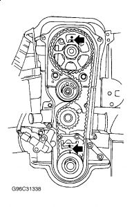

I need to know how to line up timing marks?
Saturday, October 10th, 2020 AT 9:48 AM (Merged)
DSPLC
  • 220 POSTS
This is fo 4 door 2.0L Single Overhead Cam (SOHC) engine
https://www.2carpros.com/forum/automotive_pictures/89255_IMG_2.jpg
