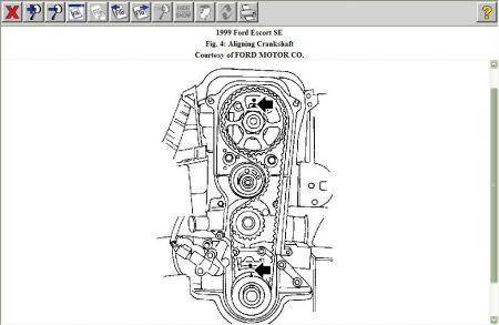

CHESTERPAULS
cambelt /pictures and settings please

https://images.2carpros.com/forum/automotive_pictures/12900_cam_1.jpg
Oct 10, 2020 at 9:44 AM (Merged)

RSTCYR77
i have a 99 ford escort and it was running fine the other day and now its hard to start.i removed the timing cover because the car is spinning frelly and that happeneds when the timing belt is loose r etc.and the belt was a little loose i tighting it up and i had a mobile mechanic come out and look at it and he said the timing had jumped.and i wanna no what u think and how do u set it and its making a knocking noise he said its because of the timing is off
Oct 10, 2020 at 9:45 AM (Merged)
STEVE LV
  • 7 POSTS
If you look at the sprockets that your belt rides on you'll see a notch or mark on the side edge... These should line up... That's how you get them in the right position when replacing the belt...
But... they may not line up with every turn, because of the position of the crankshaft and or the camshaft...
Hope that helps!

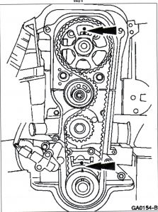

KB285401
i need to know how to line up timing marks?
Oct 10, 2020 at 9:48 AM (Merged)
DSPLC
  • CAR REPAIR CONTRIBUTOR
  • 220 POSTS
This is fo 4 door 2.0L Single Overhead Cam (SOHC) engine
https://images.2carpros.com/forum/automotive_pictures/89255_IMG_2.jpg
