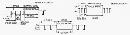

Have you read the codes yet? You may have a vacuum leak, get a can of spray throttle body cleaner, spray the vac lines and maniflod area, when the idle changes, youve found the leak! You want the engine running and spray on the outside but do direct the stream onto the hoses, if it is a vacuum leak, the engine idle will change speed, then you have detected a leak, repair the vacuum leak and see how it runs!
do this and count the flashes...Count the flashes, a 22 will flash as 2 flashes then a short pause, then 2 flashes, if more than one code is stored, the pause will be longer. The codes will display three times and end with 11 or 111. Write them down and post here. First do this with the ke on engine off, then again with it running.
https://www.2carpros.com/forum/automotive_pictures/62217_Ford96Older_1.gif

Hi. I have checked/tested for vacuum leaks. No I haven't checked the codes. Are you able to give me some guidance or direct me to a site detailing how the codes are read?

If your DLC(data link connector) looks like this, read em this way.
https://www.2carpros.com/forum/automotive_pictures/62217_Escorta_1.jpg
https://www.2carpros.com/forum/automotive_pictures/62217_escortb_2.jpg
https://www.2carpros.com/forum/automotive_pictures/62217_escortc_2.jpg
https://www.2carpros.com/forum/automotive_pictures/62217_escortd_1.jpg
EQUIPMENT HOOKUP Using Analog Volt-Ohmmeter (VOM) 1) Turn ignition off. Locate Data Link Connector (DLC). See Fig. 1 . Connect positive (+) lead of VOM to PCM STO terminal at DLC and negative (-) test lead to engine ground (GND). See Fig. 2 . Set VOM to 0-20V DC range. 2) Connect a jumper wire between ground and PCM STI terminal of DLC. See Fig. 2 . Using Malfunction Indicator Light (MIL) Check MIL operation. Turn ignition switch to ON position. If MIL is on, MIL circuit is okay. Go to next step. If MIL is off, go to CIRCUIT TEST MIL. After performing CIRCUIT TEST MIL, return to this procedure. Connect a jumper wire between ground and PCM STI terminal of DLC. See Fig. 2 . Using Super Star II Tester 1) Turn ignition off. Connect color-coded adapter cable leads to Super Star II tester. Connect service adapter cables to vehicle Data Link Connector (DLC). See Fig. 1 . 2) Connect Super MECS Adapter (007-00049 or 007-00052) between adapter cables and vehicle DLC. Slide adapter switch to EEC/MECS position. Slide Super Star II tester switch to EEC/MECS position. Using New Generation Star Tester 1) Turn ignition off. Connect power cable and data cable to scan tester. Connect Rotunda Super MECS Adapter (007-00052) to scan tester data cable. 2) Plug matching connector on Super MECS adapter into vehicle DLC. Slide switch on Super MECS adapter to PCM position. Plug power cable on scan tester into cigar lighter or use battery adapter. Using Aftermarket Scan Tester Follow manufacturer's instructions to hook up equipment and record trouble codes. Fig. 2: Identifying Data Link Connector Terminals Courtesy of FORD MOTOR CO. NOTE: After performing equipment hookup, follow appropriate quick test procedures based on type of equipment being used. See QUICK TEST. Page 1 of 1 TESTS W/CODES - EEC (1.8L) -1995 Ford Escort 4/20/2009
